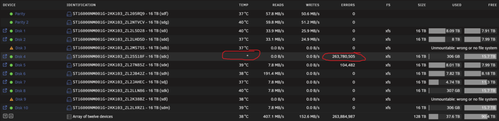

Ever since then, every time I have been trying to rebuild one disk, another one or 2 random ones drop out. As you could tell this is a pretty infuriating game of whack-a-mole.

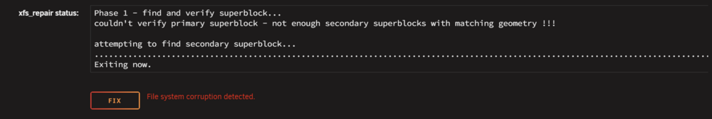

The XFS repair says "Dirty log detected" but I don't know how to deal with this.

Yes when the rebuild is completed, typically the drive is okay, but as shown in the screenshot, during the process another disk flags like disk 4, and just goes in a limbo state, and if i stop and start the array it will say disabled. Otherwise it will go orange and say emulated.

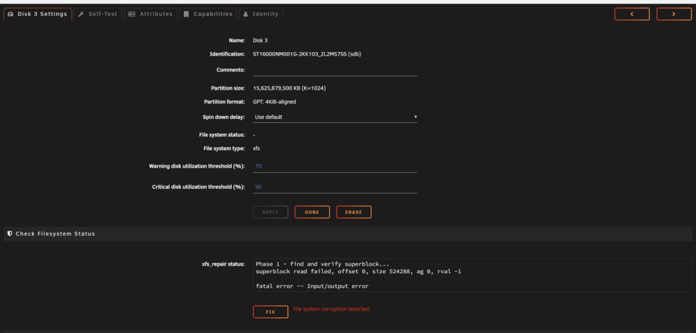

I was using this tool to check the drive

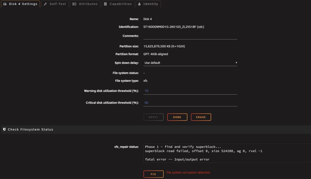

Or were you trying to check filesystem on an Unassigned Device? According to your diagnostics, sdn is not currently assigned. Maybe it was an assigned disk that disconnected.
OK, it looks like that disk is the same disk that was assigned as disk4, and it has disconnected. Not sure why you were trying to check filesystem on it, it wasn't unmountable.

SMART report for sdn (formerly disk4) looks OK, and syslog seems to indicate a problem communicating with the disk. SMART for disks 3, 9 also looks good.
Possibly emulated disks 3, 9 would be mountable if disk4 could be read. Parity calculation requires all other disks to be read to get the data for emulated disks.

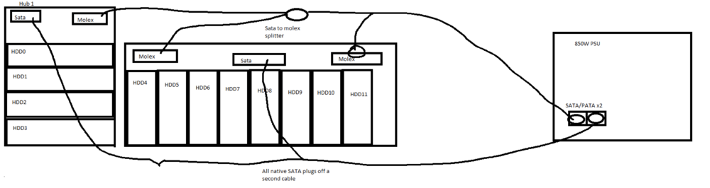

Disk 9 is on a different controller than disks 3, 4. I guess both could be overheating though.

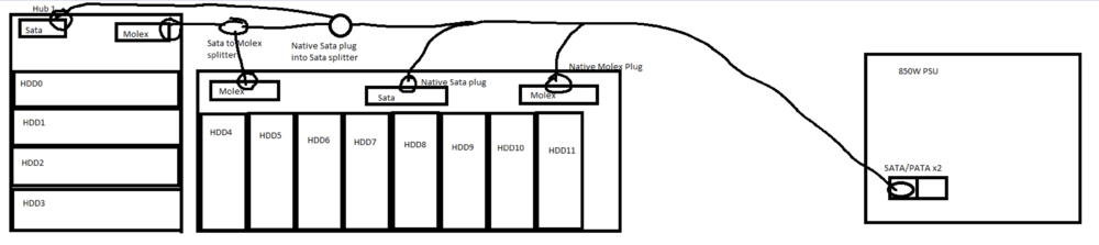

How are these disks powered? Ideally no more than 4 disks per PSU cable, MOLEX - SATA power splitters are better than SATA-SATA power splitters.

I will have to double check but if i recall correctly the first 4 are direct SATA power and the last 8 are Molex to Sata. I am using the Jonsbo N5 case.

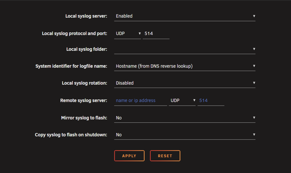

Setup Syslog Server. If you already did, you have to get the syslog from wherever you told it to save it, then zip and post it.
Post a screenshot of your Syslog Server settings.
looks like it didn't save my settings from last time, probably my mistake.

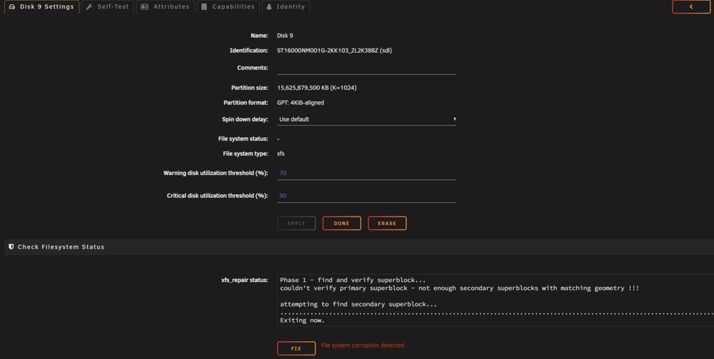

I started the array in maintenance mode and did the webGUI check disk and this is what it gave me
Post new diags after the repair attempt, before rebooting.

Yeah, those diags still have read errors on another disk, possibly more, besides the disabled ones.

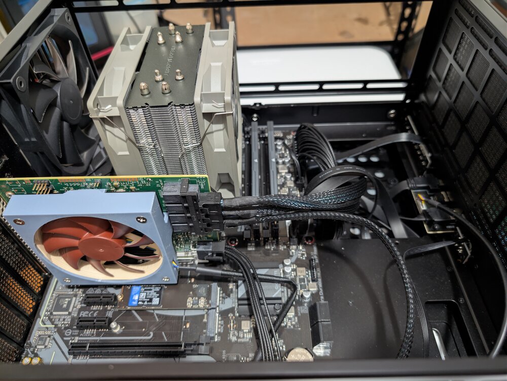

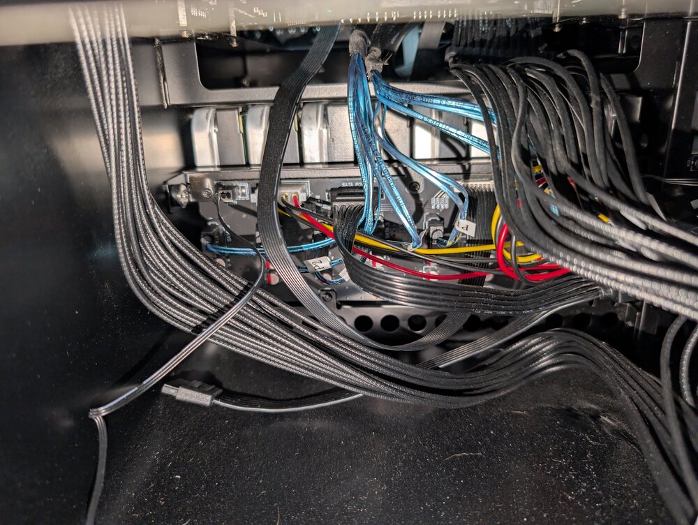

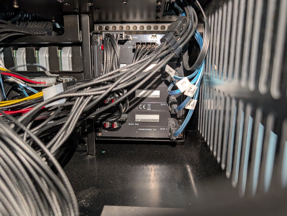

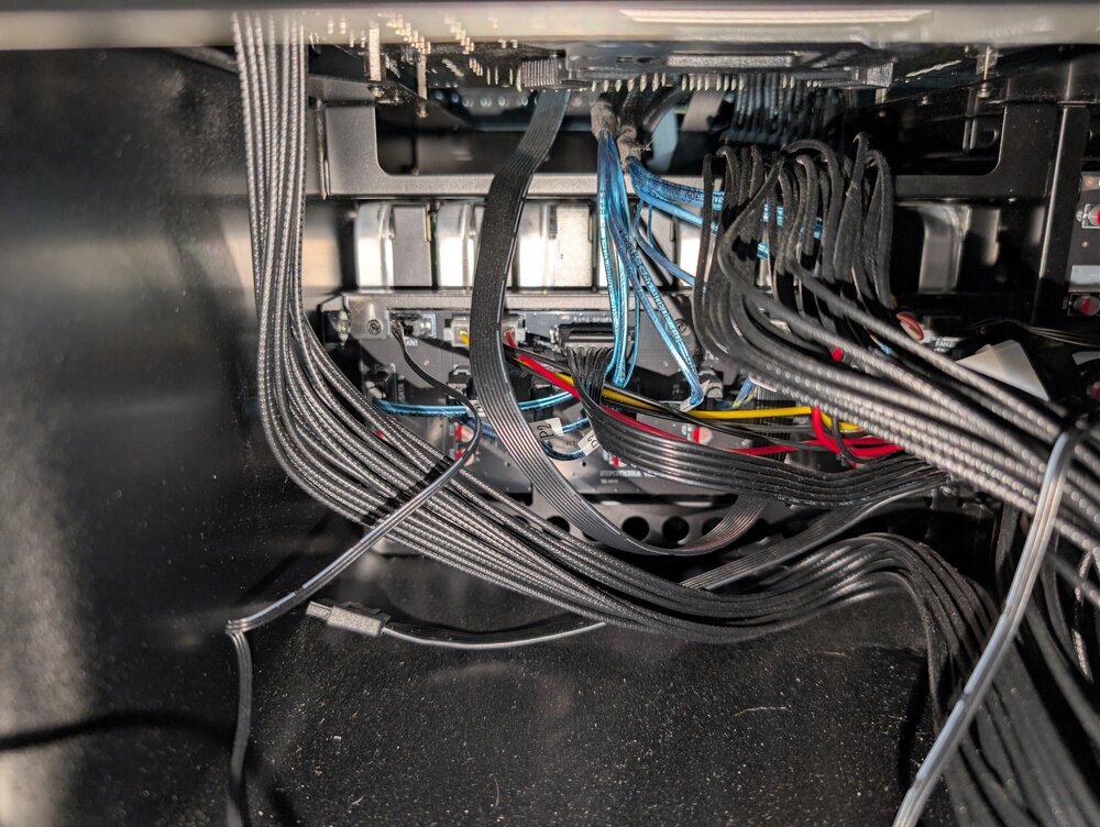

Okay so I opened it up and checked all the cables and they are all secure with slack. I reseated both sides just to be sure.
HDD 1-4 5-8 9-12 are all on 3 separate bays feeding a backplane. They are both Feb by sata power as a primary and molex as an aux power feed.
