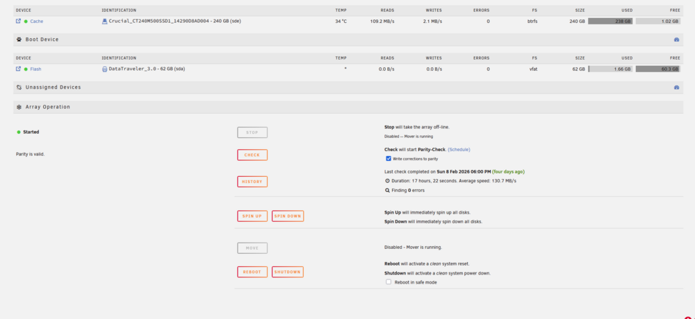

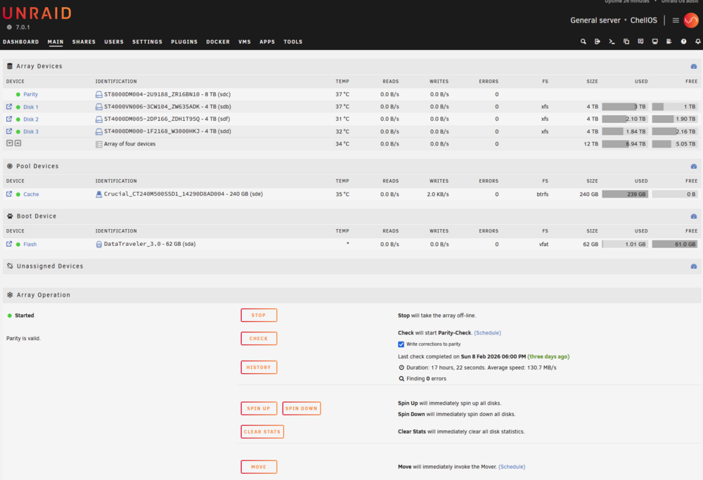

I recently noticed that my cache drive was sitting at 100% utilization. I've seen utilization get pretty high before and I've typically manually invoked the mover to move files from the cache drive to the array. This time when I tried to manually invoke the mover, my webpage flashes as if to acknowledge request, but then nothing happens. The cache drive continues to sit at 100% and I don't see any action in Reads or Writes which would indicate a move process is happening.
Anybody have any idea on whats going on or things to try? I don't believe anything has been updated but I'm also concerned that this has been a latent issue for a while and I just haven't noticed until now.

Adding screenshot
