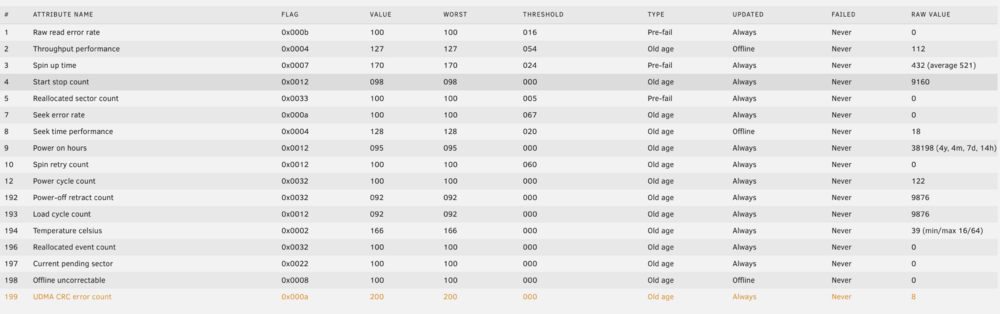

I got a notification from my sever a couple of days ago that disk3 is in error state (disk dsbl), along with another notification stating that the array has 1 disk with read errors (disk3 - errors 16). I've run a short SMART test with no errors, and now the extended test is running. Looking at disk 3's attributes I see this:
To my untrained eye nothing looks horrendously abnormal and none of the attributes has 16 errors. The only line that's highlighted is the UDMA CRC error count, but in my experience previously that's just issued a warning and not disabled the drive. Has the behaviour changed in UnRAID or do I need to keep looking for the cause of the disk being disabled?
If the count gets high enough or grows frequently, it can cause a drive to be disabled. This has happened on two of my HDDs in the past. In both cases, the UDMA CRC error count was over 1100 and growing frequently before they became disabled. This usually happened when backing up PCs to the Unraid array. I ended up rebuilding both drives onto themselves as there was nothing inherently wrong with the drive. These errors are usually the result of a bad or loose SATA/SAS cable or MB/HBA port. The drives were fine after rebuild when I swapped cables or attached them to a different HBA port.
UDMA CRC doesn't disable a disk, it is just a symptom of something that might disable a disk.
If a write fails to a disk, it is disabled, no matter the cause, because the failed write makes it out-of-sync with parity.
Connection problems may or may not cause UDMA CRC. If the disk never receives the data to checksum, it can't CRC. But it might disable the disk because the write fails. And, if the connection causes the data to not checksum, it is a CRC error, but it might not disable the disk since the data is resent.
Interesting. I've only got a CRC error count of 8, so nowhere near those numbers, but useful to know that I can't entirely discount them as the cause.
From the notifications I've had the disk is disabled due to a read error rather than a write error. Hopefully the extended SMART test will throw a little more light on the issue!
