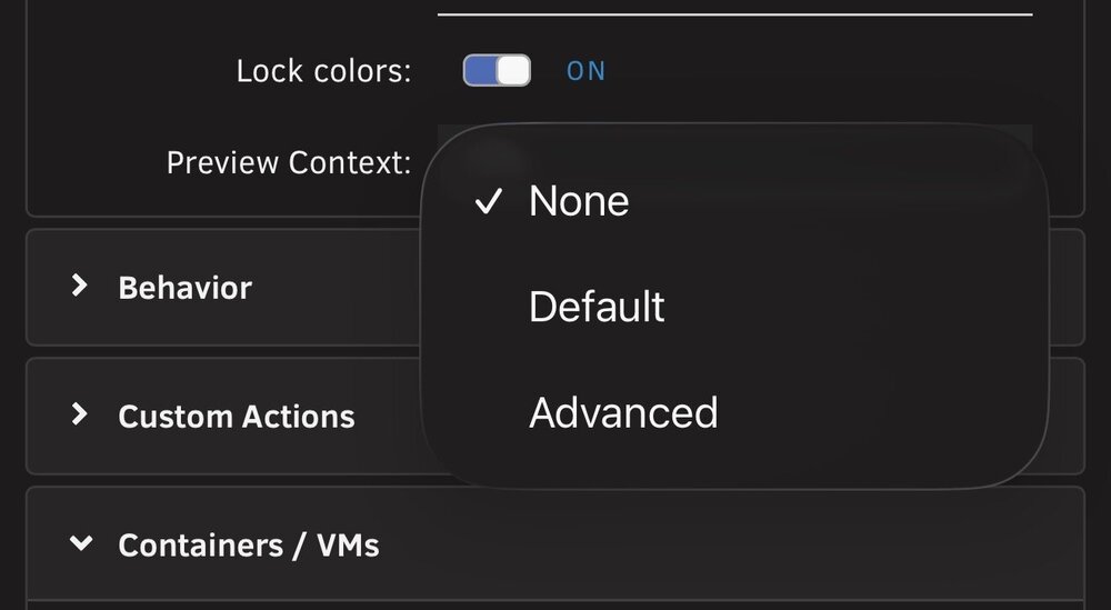

What is your preview context set to for the folders where clicking the container icon doesn’t work? It should be default or advanced.

ok that fixed it.. the ones not working were set to none.
if you create new folders it goes to none not default
so ever new folder i create it goes to none not default..
but setting it to default or advanced fixed it... didnt know this option
so wonder why some are default then? was it default in a previous version or changed from 7.2.5 to 7.3.0?

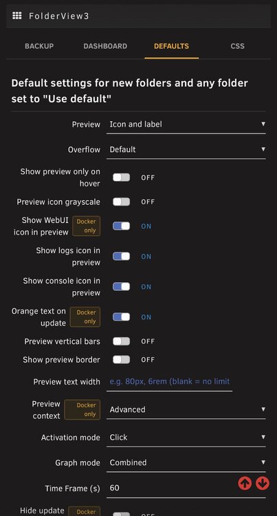

Most default settings are set to off.
You can configure your own defaults on the plugin settings page.
(Excuse the phone screenshot)
ah ok i set it.. i wonder if its because i came orginally from v2 or the v3 plus but didnt like the plus and liked the v3 which was like v2 that is defunct...
least its backup and working.. i appreciate your help as i didnt know what was wrong lol

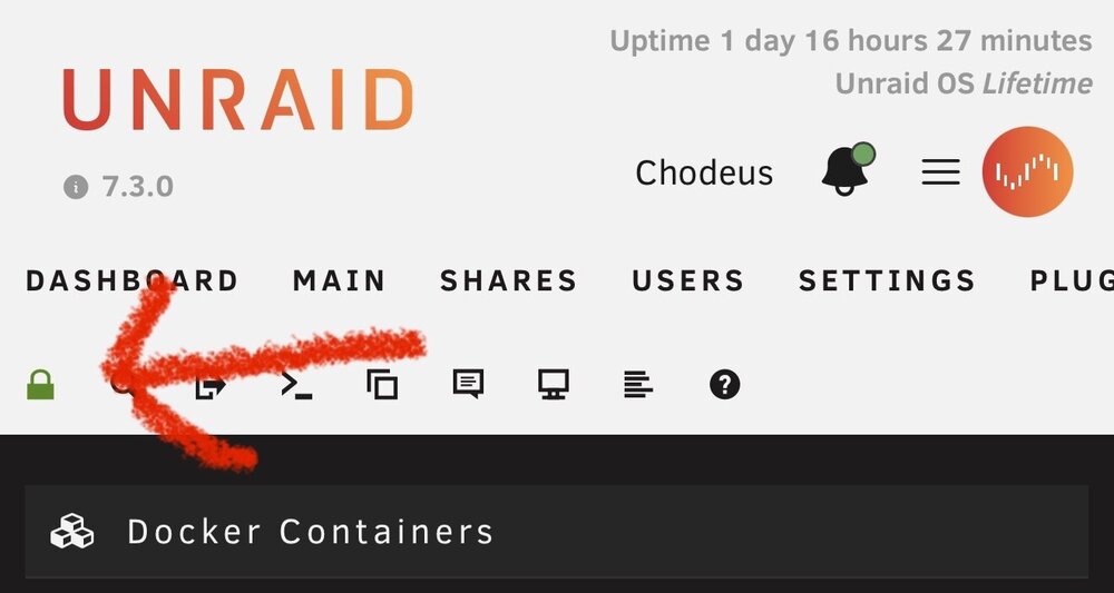

There’s a green or red padlock button on the docker page. If you’re on a PC, it’ll be the top right of the docker page. This is standard Unraid.
Click that so it’s red/unlocked and then drag the folders to create the order you want just like you would if FolderView isn’t installed.

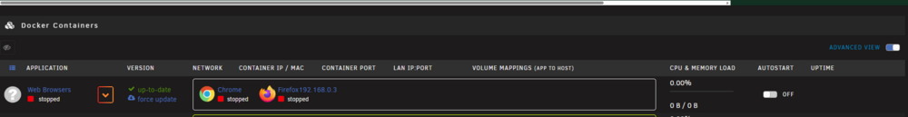

as for this green or red padlock i dont have it all i got top right is Basic/Advanced Toggle mode button nothing else there
and ill take a look at this graphic learn something new everyday.. i figured the wait was just wait after everything else is starting
maybe mine is not enabled? maybe i gotta enable it from a different location?
Edited by comet424
Where’s your webui banner?
oh i see it now its green same color as my background it doesnt show up right lol
ugh always something lol
thanks i got it sorted... frustrating as my top bar is close to the green so you cant see it easily
learn something new everyday... i appreciate it (:

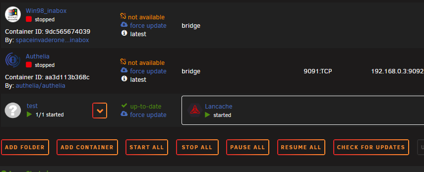

so when i re organized them but when install a new application it adds it to the bottom of the list and so are the folders now get added to the bottom of the page.. where they would be added at top

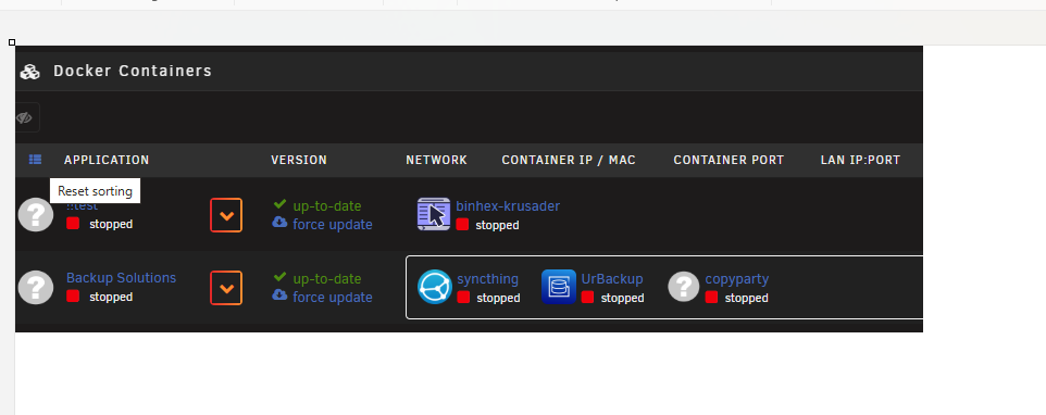

i did try unlock that pad lock and clicking the button Reset Order beside application but nothing happens
when you do the manual order with folderviews does that mean it can no longer alphabetical the applications that are not in a folder
What is this “reset order” button on the docker page?
If you add containers you’ll need to sort them unless you have a folder setup for regex matching.
ah ok so once you unlock the docker page and move folders around it buggers up newly installed applications then by adding A after W
as i figured once i organized the Folders and re locked it... that when i install a new application it would go in alphabetical order again so A would go under the last Folder view but not at the bottom of the page
and reset order is beside application but it doesnt reset my order i cant get A to go back up on its own

here it adds the folders to the bottom of the screen now i figured once i locked it would re add the folders to the top guessing not

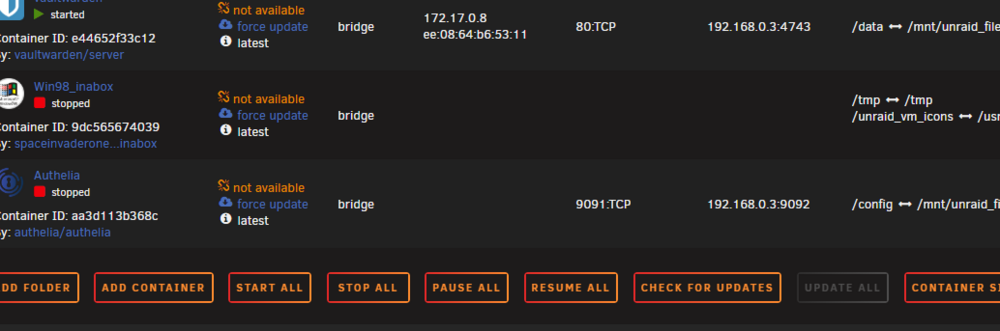

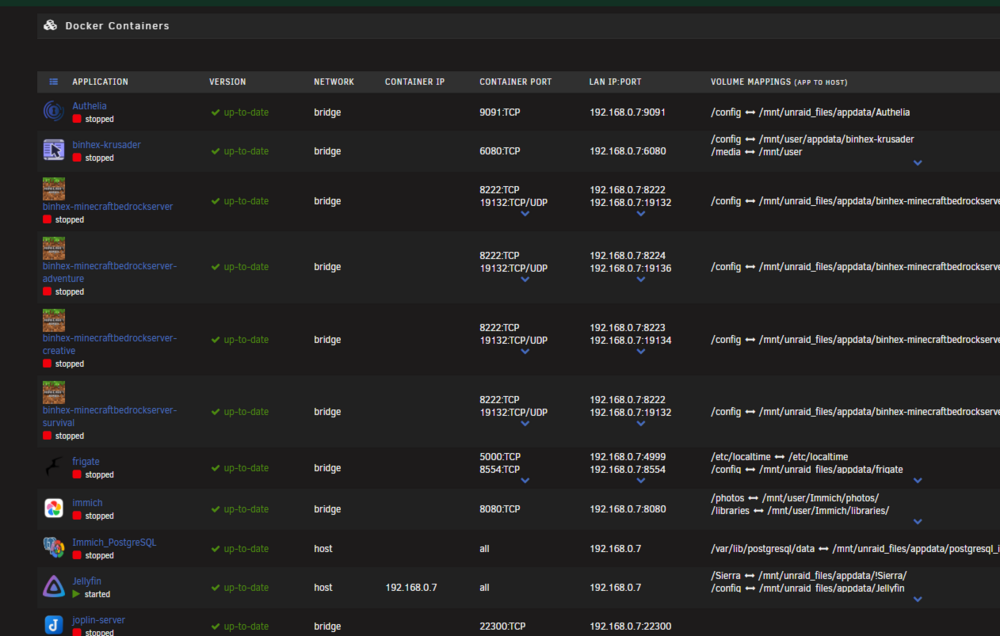

here is a my one server its a virgin of the folderview and the unlock/lock pad lock i didnt install them in alphabetical order nore moved them just random installed as i go
you see the authelia i installed that like 10 min ago and you can see it goes in order... so its in alphabetical order when you dont touch it...
so i tested it on my virgin server
so if i re arrange the orders of all the names... lock it refresh stays locked when i unlock and hit the reset order then it resets it back to alphabetical...
stupid ms one drive not working was able to to make couple videos
but the testing i did
1.. virgin server you can scramble the order and click reset order it resets back to alphabetical order
2.. with folderview installed and make a few folders when you add a new application it puts that application in alphabetical order.
3.. with folder view installed and you move the folders in alphabetical order... and you install a new application it adds it to the bottom of the screen and folder views get added to the bottom of the screen.. the folder views no longer get added at the top of the screen..
4.. with folder view installed and you just add folders they get added at the top of the screen thats without touching the order just leaving it.
so seems there is a flag or something that stops the order or placing the folder views at the top of the screen but to the bottom once you manually re organize the folders themselves
