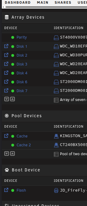

  6. I followed instructions and now I can't see an emulated drive and don't know what to do next.
What have I done?
  1. I popped the smaller drive back in the machine.
  2. I did New Config with keeping all devices assigned, I checked that all the drives were still in the same slots with the failed drive "unassigned"
  3. Started the array in maintenance mode with "parity is valid" however it showed no "missing drive".
  4. Rebooted the machine and started the array normally, still no "missing drive"

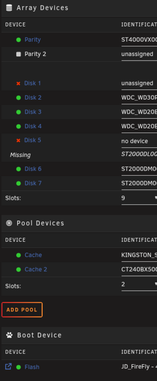

Ok I have done as advised.
The missing disk is being emulated according to the GUI. However it does not appear that the emulated disk has mounted. I can't see it under /mnt/.
Should I proceed with adding the new drive so that it rebuilds it from parity?
If the emulated disk is not mountable then the rebuilt disk would not be mountable either.

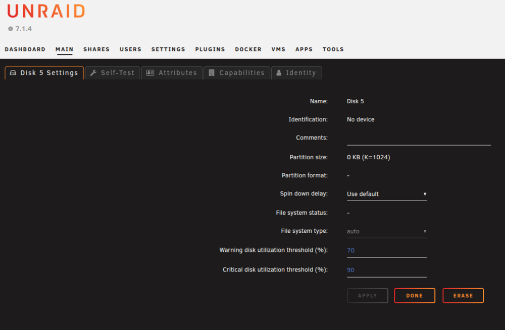

Check filesystem on the emulated disk from the webUI and post the output
There's no option for "Check file system" on the webUI. And Trying to check via command line doesn't seem to be working either.
1 hour ago, funkyfedaykin said:
"Check file system"
Did you start the array in Maintenance mode?
Yes
Set the File system type. I assume it was XFS?
It is XFS, however on the missing drive on Main it says "auto"
That is where you need to set it to XFS
