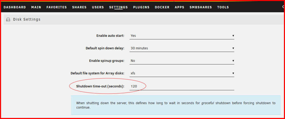

Two things— First, determine the time required to stop the Array using the button on the MAIN tab. Then make sure that this setting is long enough to allow for the array to be stopped.
Second. Think about your UPS for a minute. Realize that it has enough energy stored to run your server fro twenty minutes to, perhaps, an hour. It will take a minimum of eight hours to recharge that battery if you run it to almost fully discharge. Now, think about your power interruptions. In my area, we have two kinds of interruptions. One is the power company maintenance ones. They last less than ten seconds. Then there are all the other types. They last for a couple of hours at a minimum. I have set my UPS to only run thirty seconds on battery before requesting that the server be shut down.
Remember that the "Time on battery before shutdown (seconds):" parameter only starts the shutdown. It can take several minutes after that you actually get your server shutdown cleanly. (Part of this time is flushing all the cached writes from RAM onto the physical media where it is safe.) I f you are like most of us, after power restoration, you want to get the server back on-line ASAP. Remember that the battery is now partially discharged and it will be several hours before recovery to a fully charged state. You want it to have enough reserve to be able to handle a second outage.

You time how long it takes to stop the array tidily by pressing the Stop button in the webGUI and then provide for a margin above that. There ae separate timer settings available for closing VMs, all docker containers, and then stopping the array. so make sure they are all large enough.
Thank You guys. That's some great tips. i will give does a test. now that i can see my appdata content again after the command from JorgeB . is it safe to just reinstall the dockers ?
