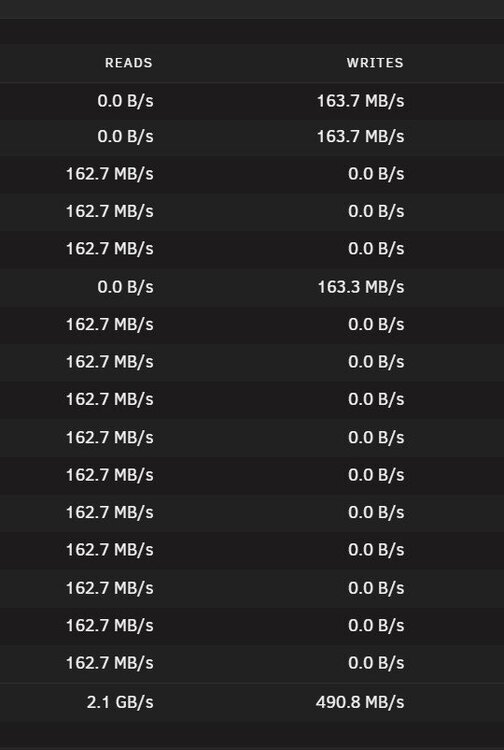

There seems to be a problem with parallelism when writing to the array using Reconstruct Write. I have data in my NVMe cache that needs to be transferred to the array. My server has a large amount of RAM which is used as a disk cache automatically. The data in the NVMe cache is split by folders to different drives in the array. If I move one folder using Midnight Commander to the user0 folder I get full speed writes:

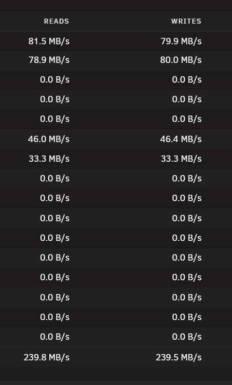

However, the MC move finishes quickly as it is copying to the RAM cache. When I start another folder move to the array (which uses a different drive), the write performance tanks and the disks are noticeably louder:
It appears that the RAM cache doesn't operate as a FIFO buffer and that Turbo Writes are switched off when two operations are executed.
Now you may say, "simply wait until disk activity has stopped before starting another move", it's difficult to know when this has happened programmatically, which means that when Mover executes, it defaults to Read/Modify/Write if it's moving data to multiple disks.
Is there a way that Mover can stop additional moves until the single disk activity has finished? Or can Unraid be clever enough to calculate parity for all drives for multiple disk writes without resorting to Read/Modify/Write?

TurboWrite is automatically disabled if there are writes to more than one device. For best results, avoid that, since writes to parity will also overlap, e.g., don't use the most free allocation method, which will require constant disk swtiching and parity overlap.
