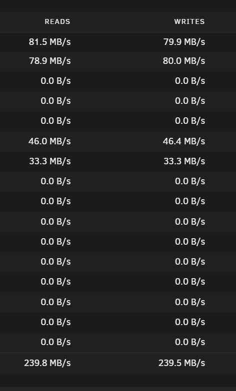

  6. I'm not sure you understand what I am talking about. I'm not doing Turbo to multiple disks. Unraid is due to the way the RAM disk cache works. If what you say is correct, Mover won't ever work with Turbo Writes - just in case the data is split across disks.
  7. Not really a great answer, suppose I have data in the NVMe cache that needs to be placed on 14 different disks due to the share setup for the array. Currently that data will be concurrently written to all the drives at the same time using Read Modify Write. Making the cache FIFO means that each disk is written to one at a time.
  8. Yes, the Linux disk RAM cache is what I mean. It's not FIFO, you can test this by copying data to a share that's housed on one array disk, then copy to another share that's housed on a different array disk. I wanted it to wait on disk writes before starting to write to the 2nd disk. That to me is the logical way to handle a cache for an Unraid array (due to performance limitations). For an array that's on an NVMe raid, concurrent writes may be possible, but I would still assume that it's best to get the first job done before starting others.

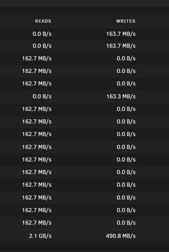

  9. Hi all, There seems to be a problem with parallelism when writing to the array using Reconstruct Write. I have data in my NVMe cache that needs to be transferred to the array. My server has a large amount of RAM which is used as a disk cache automatically. The data in the NVMe cache is split by folders to different drives in the array. If I move one folder using Midnight Commander to the user0 folder I get full speed writes: However, the MC move finishes quickly as it is copying to the RAM cache. When I start another folder move to the array (which uses a different drive), the write performance tanks and the disks are noticeably louder: It appears that the RAM cache doesn't operate as a FIFO buffer and that Turbo Writes are switched off when two operations are executed. Now you may say, "simply wait until disk activity has stopped before starting another move", it's difficult to know when this has happened programmatically, which means that when Mover executes, it defaults to Read/Modify/Write if it's moving data to multiple disks. Is there a way that Mover can stop additional moves until the single disk activity has finished? Or can Unraid be clever enough to calculate parity for all drives for multiple disk writes without resorting to Read/Modify/Write? Thanks, Andy.

    Found the problem. It appears that Power Mode in 7.2 has a really significant change from Efficientcy to Best Performance on my R730XD. Everything is incredibly snappy when changed to to Best Performance - even increasing network transfer speed.
