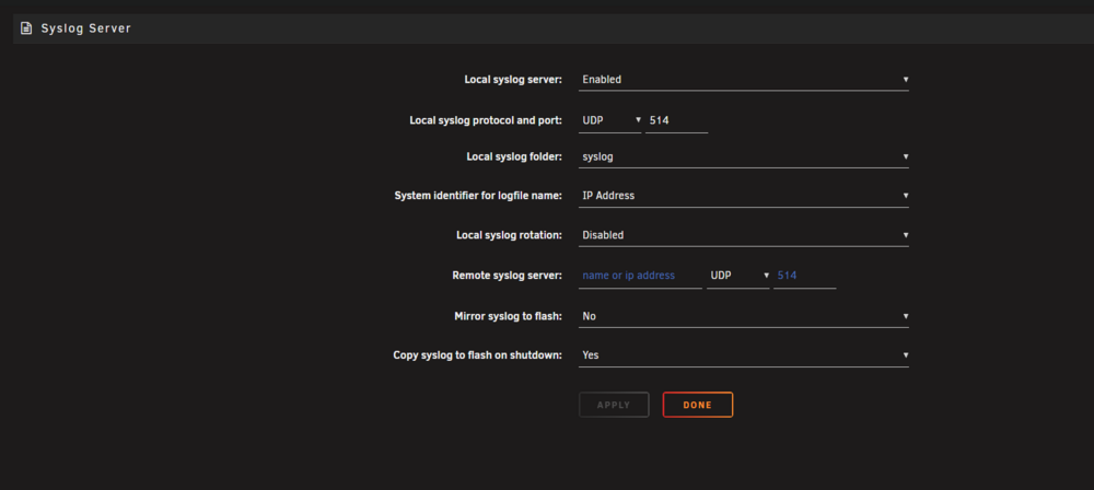

Over the past couple of days I enabled the syslog server and got the server to crash multiple times. But, there are no files in the syslog folder. I tried different setting for the syslog server and still nothing. With my inexperience I do not know the correct or best way to setup a syslog server. I used the directions linked by Veah, but it doesn't really detail all of the possible settings - if they are even applicable. Unless you have something else I should try I think this is what I am going to do: I am going to install the trial version of Unraid on another flash drive and see if it will be stable that way. Since I only have the two services running and a handful of plugins it shouldn't take more than a couple of days. Should I pursue this course?
Here are my syslog settings:
With those settings, the syslog server is just listening for syslog messages from other machines. As mentioned in the link if you want the server to record its own messages you either need to put your server's address in the remote server field, or set the 'mirror syslog to flash' option
Just put localhost for "Remote syslog server" then it should save to your syslog share. Mirror to flash may not work because
