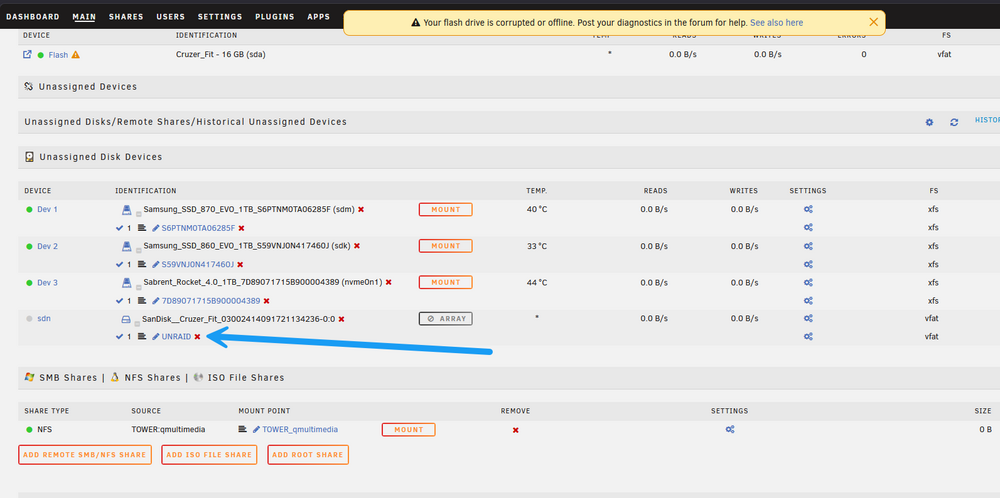

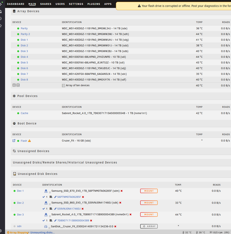

Had a CMOS battery fail which crashed the whole server.
Replaced battery and got server back up, it did the partity rebuild 26 hours and done.
The next morning the USB boot drive fails. Replaced it and back up and running but now It once again needs to do the whole unclean shutdown and parity rebuild again. I know USB's boot is soon to be replaced and hopefully this will resolve a good amount of these types of issues but arghhhhhh. This puts more wear and tear on the drives and stressing me out waiting for it to finish again - Worried if a storm or power fail and UPS runs out of juice, another unclean shutdown.
I was in a VM and the whole remote desktop closed and the server main showed this: (2 screens to fit it in) But it was not shutting down and kind of stuck which is what was the problem.
