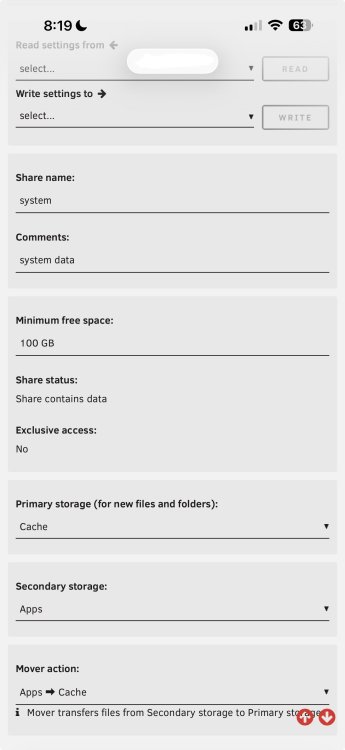

Okay, i really appreciate your instructions but i’m sure i messed something up because im dumb lol. Here is what my system share settings are now, after moving they still exist in the cache not apps drive. Thanks for any help!
You didn't
2 hours ago, pleasehelpmeguys said:
set mover from Cache -> Apps
41 minutes ago, trurl said:
You didn't
Genuinely, i’m embarrassed and am sort of concerned about my reading comprehension lol. 🙈 Thank you, i’ll try it and report back. Let’s pretend like this never happened ( please)!
Huzzahhhh! Worked perfectly. Now the cache drive just has 154mb taken up which is random. Do i have to change any settings or anything in the system share or do i just leave it as is now? Thanks a ton guys.
