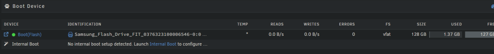

Your boot drive is corrupted or offline. Post your diagnostics in the forum for help.
This seems to keep happening to me, trying not to blacklist another USB drive. Any ideas?
mibix-module-diagnostics-20260820-1930.zip
Seems to come and go quite frequently without me doing anything.
It still shows up in the webGUI and I am able to access it so I don't know what the deal is:

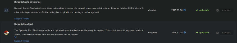

I do have these two dynamix plugins installed:
