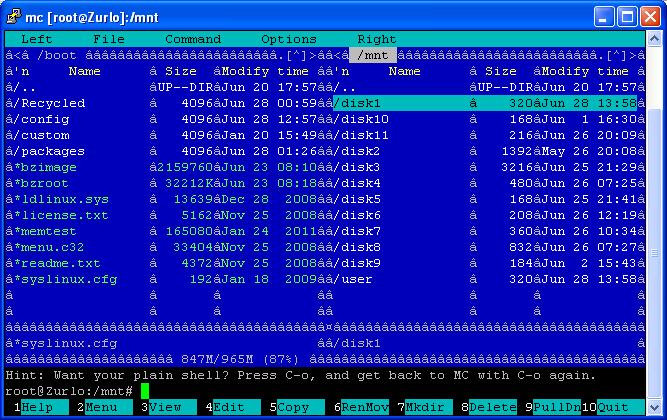

I think I found it - under "boot" in Midnight Commander....  Log attached.
Also, Midnight Commander looks "strange" with weird a's surrounding everything instead of asterisks.  Any ideas on this?  Should I be concerned?  (Image attached).

IIRC, Midnight Commander requires a different font set...let me do a search.
Edit:
http://lime-technology.com/forum/index.php?topic=18157.msg162839#msg162839
In your Putty-configuration, go to Window->Translation and set Remote Character Set to something like UTF-8
By the way, if you change the active session, you may have to restart MC for changes to show up.
Edit2: btw, that syslog is from Jan 31 :o

Thanks for the help - you got my Midnight Commander all beautiful again!  :-)
