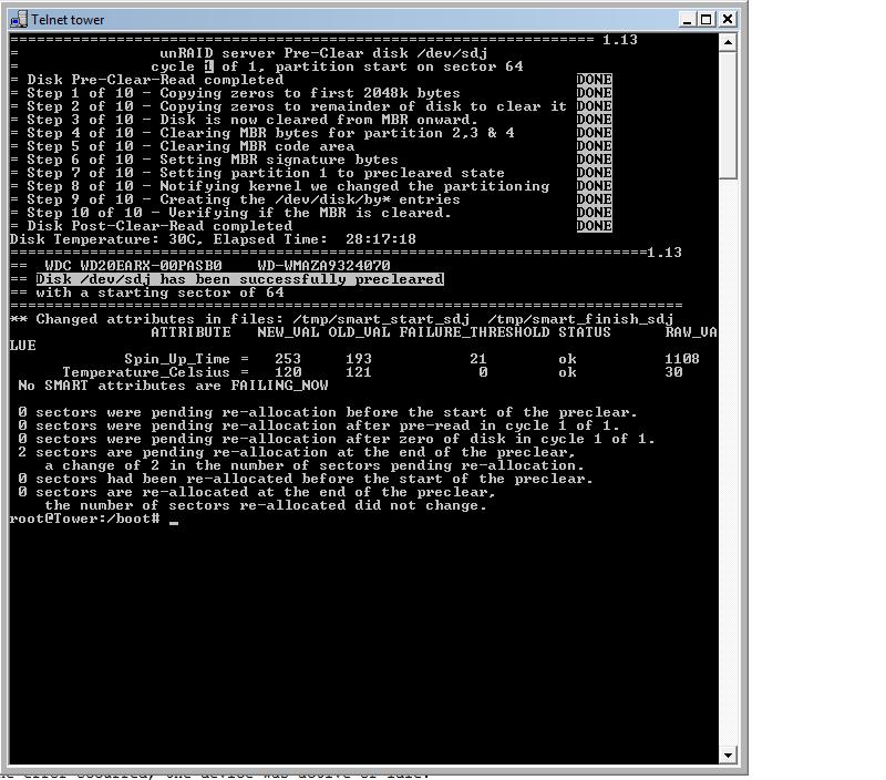

Final smart report and preclear attached

Although success is reported, I'd not consider that a successful pre-clear. Repeat pre clear until there are no pending sectors and the reallocated sector count is stable.

Ok well no surprises there. I suspect most of my problems are due to this batch of drives being junk. I started running another preclear on it but it was already heading for error city crashing. I'll swap this drive again, possibly with another brand and hope that clears things up.
I'm using a Airport Express as my router and forgive my newbieness but I have no idea what that is. Any advice on how I might go about changing it would be very appreciated
Traded in the 2TB WD drive for a 1TB and successfully ran a preclear with no errors in my syslog and no other problems.
Issue appears to be solved. Thanks so much everyone for all the help!
(Also managed to change my DHCP renewal time)
