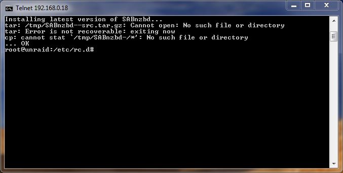

I had sabnzbd installed and working fine until I rebooted my machine today.  When I try and install the sab package, it hangs and won't download.  I removed the plugin and all traces of it and re-installed but still no success.  (using the latest from github).
I think it hangs on the version check.  It never downloads the sab src.tar.gz package.  Attached is a screengrab of the output.
My other Influencer packages CP, sickbeard and airvideo all install fine.

well, here is the same ;(
root@Tower:/boot/config/plugins# /etc/rc.d/rc.sabnzbd start
Installing latest version of SABnzbd...
tar: /tmp/SABnzbd--src.tar.gz: Cannot open: No such file or directory
tar: Error is not recoverable: exiting now
cp: cannot stat `/tmp/SABnzbd-/*': No such file or directory
... OK
Starting SABnzbd: sudo -u root python -OO /usr/local/sabnzbd/SABnzbd.py -d -s 0.0.0.0:8090 --config-file /mnt/cache/unraid/apps/sabnzbd --pid /var/run/sabnzbd/ > /dev/null 2>&1
python: can't open file '/usr/local/sabnzbd/SABnzbd.py': [Errno 2] No such file or directory

The issue is with sourceforge. I can band-aid it but it will break the upgrade functionality in the mean-time and alway say there is an update but won't tell what version.

Until I can get the temp fix up please do the following:
cd /tmp
wget -q -O sabnzbd.tar.gz http://sourceforge.net/projects/sabnzbdplus/files/latest/download?source=files
tar -xf sabnzbd.tar.gz
rm -Rf /tmp/sabnzbd.tar.gz
cp -Rf /tmp/SABnzbd*/* /path/to/your/installdir
rm -Rf /tmp/SABnzbd*
for the /path/to/your/installdir if you currently have it set to install to /usr/local/sabnzbd you would run "cp -Rf /tmp/SABnzbd*/* /usr/local/sabnzbd/
You MAY have to make the install directory, the plug-in should have done this but if you get an error running the cp command that the directory doesn't exist, run this:
mkdir -p /path/to/installdir
example:
mkdir -p /usr/local/sabnzbd
I'll get a fix up as soon as I can, gotta run right now but will push it when I get home.

Sweet, that workaround does it.  Thanks Influencer for the quick support.
