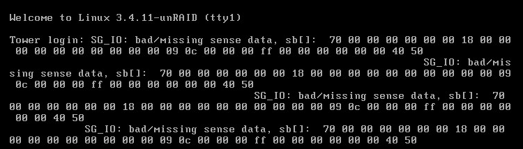

October 2, 201214 yr Hi, I have just upgraded from 5.0-beta12a to RC8, which seemed to be just fine. The array is started and working fine, but on the console I keep getting the following error: SG_IO: bad/missing sense data, sb[] ... I attached a screenshot of the console, and the system log. Running unRAID as VM under ESXi 5.1, with RDM for data drives. - Itamar. unRAID-5.0rc8-post-upgrade-system-log.txt
October 29, 201214 yr I just went to RC8a and my console keeps getting spammed with the same. On a hunch, I removed my RDM'ed SSD cache drive and it went away. I guess it's trying to read sensor data from the SSD which isn't there (i.e. temperature etc.) It's annoying yes.. but it doesn't appear to log the constant spam anywhere so I guess it's just annoying

October 29, 201214 yr Thanks for the heads up - will keep an eye on things and let you know if I experience anything similar. I don't think it's related though, as info out there suggests that the error is produced by an inability to read certain sensors on a drive. RDM'ing doesn't allow things like temperature sensors etc to talk to unRaid. In your case, I'd say it's because all your data drives were RDM'ed. This is supported by the fact that my 8 data/parity drives (on M1015's passed through to the unRaid VM) don't display this issue once the cache drive is removed from the array. I think the core of the problem is the fact that we are RDM'ing drives - I might just add my cache drive to one of the backplanes in my Norco so it's passed through and get rid of it that way.

December 30, 201213 yr Has anyone figured out the cause of this problem? I'm also running an SSD passed through via RDM (ESXi) to Unraid. I'm curious if this is an error I should be concerned about, or just a nuisance? It makes it nearly impossible to use the Unraid console in ESXi. I'm also on Unraid rc8a and have attached the messages I'm getting.
December 30, 201213 yr Has anyone figured out the cause of this problem? I'm also running an SSD passed through via RDM (ESXi) to Unraid. I'm curious if this is an error I should be concerned about, or just a nuisance? It makes it nearly impossible to use the Unraid console in ESXi. I'm also on Unraid rc8a and have attached the messages I'm getting. The only solution I know of is to pass the controller through to unRAID VM rather than individual drives. The error is just a nuisance so you could ignore it. However if you have any spinners that are RDM as well they will not get spun down.

August 16, 201610 yr Don't have an answer for you - hopefully someone else will. I only have one ESXi server left and it will be bare metal unRAID in a month or two. Maybe less. Is there even a way to determine which drive it's trying to read the data (I'm guess hdparm) from? What is your SCSI controller 0 set to? I accidentally set mine to something other than VMWare Paravirtual, and was getting the same error as stated in this thread. Moving it back to VMWP fixed it.
