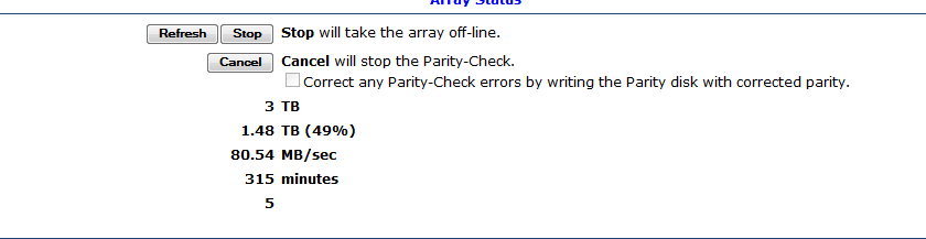

I am running the 5.0rc8a software.  Running a routine parity check in preparation for swapping out my parity drive for a new unit.  Ran a check 10 days ago, no errors.  Tonight for the first time, I am seeing errors during my parity check and I am very worried.  I usually run a non-correcting parity check, and I am 99% sure I unchecked the box again this time before starting the parity check, but $%^^&*((^ parity check is correcting errors and I have 5 so far - about half way through.  They seem to have been corrected.
The errors seem to be in a cluster, detected about 2.5 hrs into the check, and within the same second, according to the log.  Since they have been corrected, I would like to identify the file(s) that have been affected - can someone please tell me how to determine the filename of the file(s) affected by the incorrect parity?
I am also confused by the two web screens - the Mymain page says the parity check is correcting:
But the Unraid main seems to show that the "correct" box is unchecked and the errors uncorrected?
I'm attaching a log file.  I'd really appreciate help on this - I am concerned about data loss.  Secondarily I am very upset that I am unable to run a non-correcting parity check, from the Unraid Main web page, even though I am pretty certain that I selected not to correct.

It's not correcting.
Jan  5 17:22:21 Repository kernel: mdcmd (408): check NOCORRECT
There is no way to determine why you are getting the errors unless you find a disk that is acting up and not reading correcting. No way to determine which file is affected either.
Thanks for pointing that out - I should have noticed that.  So this is something not right with the way Unmenu interacts with the rc, I suppose.
