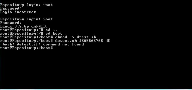

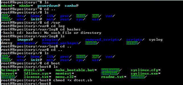

How are you running the script? Copy and paste the terminal session that shows it run.
Here you go.
I see where you changed permissions to make the script executable, but I don't see where you actually ran it.

Yes.
Next enter "detest.sh 1565565768 40" to run the test. chmod is only needed once.
I apologize for being thick.  I think you asked me to do the following, and that's what I did.  no dice:
chmod +x dtest.sh
Should i run this from a different directory?  Im running it from /boot.
it tells me command not found.

Yes.
chmod +x dtest.sh
I think there may have just been a typo in dgaschk's instructions. if you remove that extra 'e', does it work?
