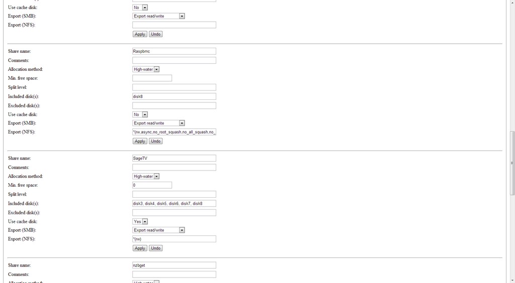

Those instructions are not applicable. Show a screen shot of the share setup.
Thanks for the help...I really appreciate it.  Attached is a screenshot.  I am not sure why you made the statement that the instructions are not applicable?  Please note in the screenshot that I have a share just below the Raspbmc share that works.  The raspbmc share is different though as the raspberry is connecting to the share and running xbmc.  The developers created the link that I shared to indicate how the nfs share should be configured.

How is xbmc configured? Use the following:
 nfs://user:password@Tower/mnt/user/yourShareHere

Dgaschk,
To illustrate my post above here is the text from my telnet session...when logged in as root I see the folders?????  Also here is the settings of my export in unraid
*(rw,async,no_root_squash,no_all_squash,no_subtree_check):
