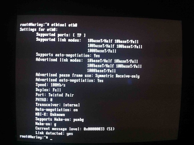

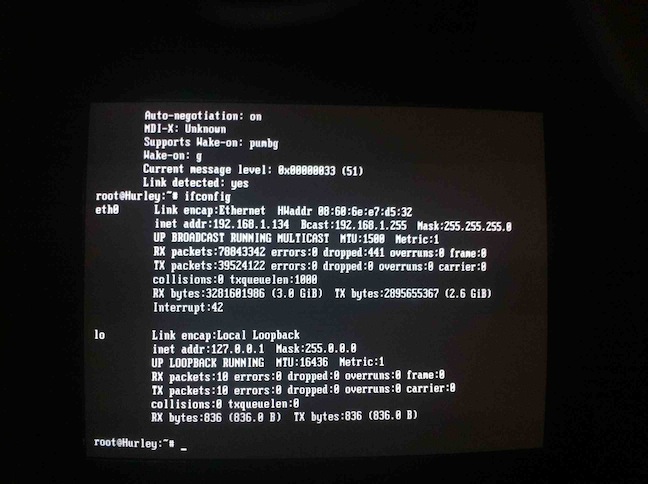

Attached are two images of 'ifconfig' and 'ethtool eth0' readings.
I am running full duplex. However, speed is only indicated at 100Mb/s - could be the issue - how do I get that corrected??
I don't know how to interpret any of the readings on my ifconfig

That is 100% your issue.  I assume when you said a disk1 to disk2 transfer that was through a client, i.e. via the Mac?  If you did the copy solely on the box via mc it should be much faster.
Since I'm still a Linux noob, I have no idea how to troubleshoot the fact that your server is connecting at 100 Mbit other than the obvious. Is the server connected with a quality CAT5e or CAT6 cable?  CAT5 won't cut it. Is it a premade cable, or did you crimp it yourself?  Have you tried a different port on the switch?

Probable reason why I'm only getting 100mb/sec? I looked up my wireless router specs and saw the ethernet ports only support 10/100!! Gosh I just assumed since I had a wireless-N router (Linksys E900) that the hardware was at least decent. So I guess I need to go out and get a Gigabit router? Any Suggestions for best router for the price?
