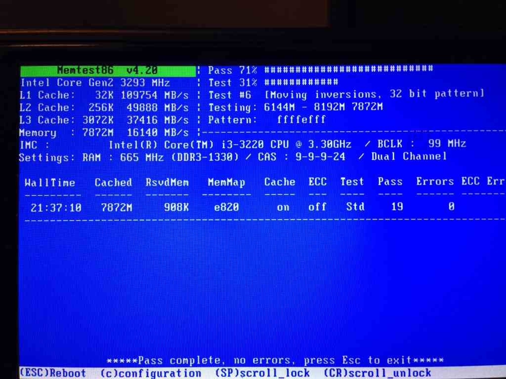

Your .sig indicates that you have 1333MHz memory, yet memtest is reporting 665MHz - this doesn't sound right.  It may be that the version of memtest in use isn't fully compatible with ivy bridge cpus and is reporting an incorrect value.  However, if it really is running at 665MHz, this isn't a valid test of your memory.
I'm not clear whether you are running memtest86, or memtest86+ - the screen shot is confusing (the latter usually reports as 86+, the former should show a version of 4.2.0, with a slightly different screen layout ... my guess is that you are running 86+, but the '+' isn't showing).  memtest86+ development appears to have stagnated in January 2011.  memtest86 has had a couple of revisions in 2013, after two years stagnation.  Unfortunately, the current releases of both versions are 4.20 (or 4.2.0).
Thx all!  Yes I have 1333MHz memory.  I just run the memtest from unRAID boot USB.  What else I should do with memtest?  How to get 1333MHz shown instead of 665MHz?

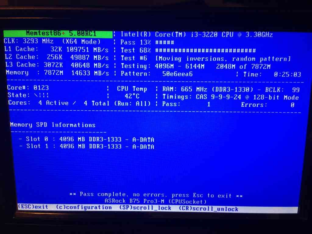

I can't the is any + sign so I expect I'm running memtest 86.  I just take another screen shot, hope it is more clear.
Up to now, I can't see any error yet.
I just download Memtest86+ 5.00RC1 and start another run memtest.  Stay tuned.

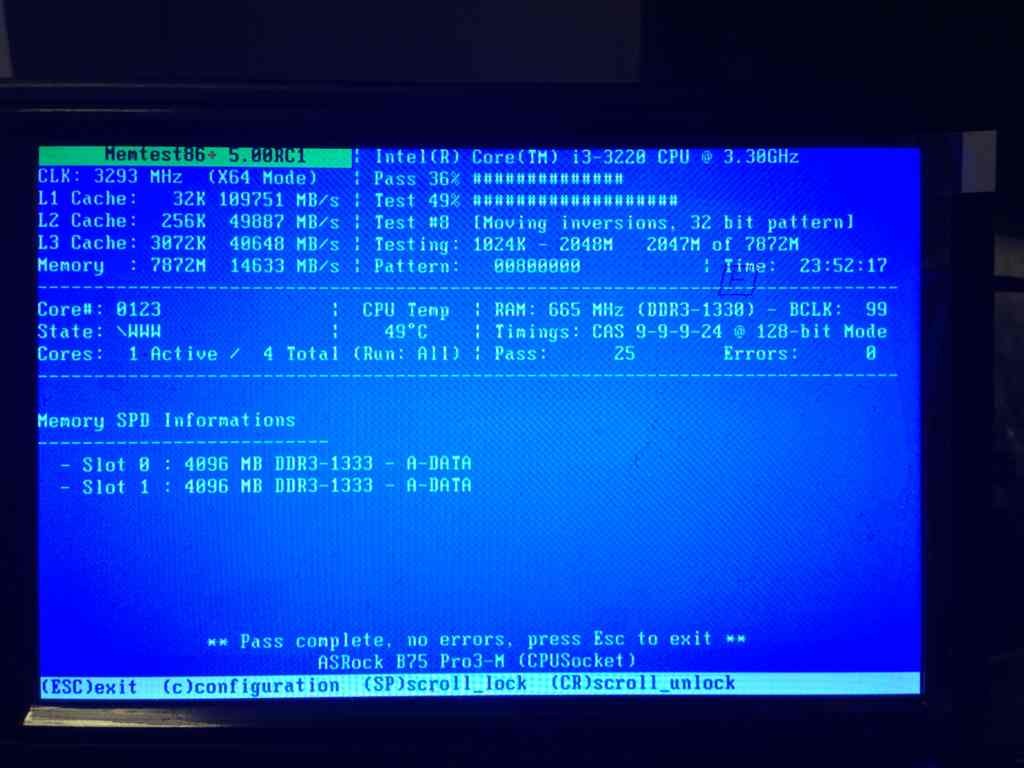

Hi all, after another 24hrs, test with Memtest86+ 5.00rc1, here the result.
Is it a gd news?  Or bad news?
Looks fine -- 25 passes with zero errors is a good indication that your memory's fine.
That's "good" for the memory;  but doesn't help isolate why you're having the intermittent issues.
How many disks does your system have?
Memtest is still appears to be reporting the memory speed as 665MHz.  If this is accurate, then there is still no validity in the test.
It's DDR RAM  :)
"Dual data rate" ==> transfers on both rising and falling clock.    MemTest is reporting it just fine ... a 665MHz clock = DDR3-1330.    In theory it should show a 666MHz clock, but I wouldn't be concerned with a 1 cycle difference in the clock  8)

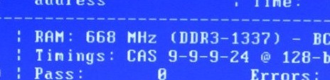

@PeterB, i found something interesting.  When i look at the sample screenshot from Memtest86, it showing 668MHz for his DDR-1337 ram.  Could anyone show me your Memtest86 screen as a ref?  Do u know how to set it to expected speed to run Memtest86?
http://forum.canardpc.com/forums/73-Memtest86-Official-forum#threads/68001-NEW-%21%21-Memtest86-5.00-RC1-available-%21-Need-betatesters-%21?forcenoajax=1
