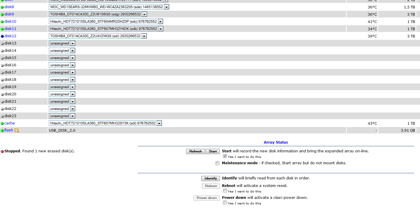

I'm attaching what I see when I select the drive in any available slot.  In this case I selected the new drive as disk12.

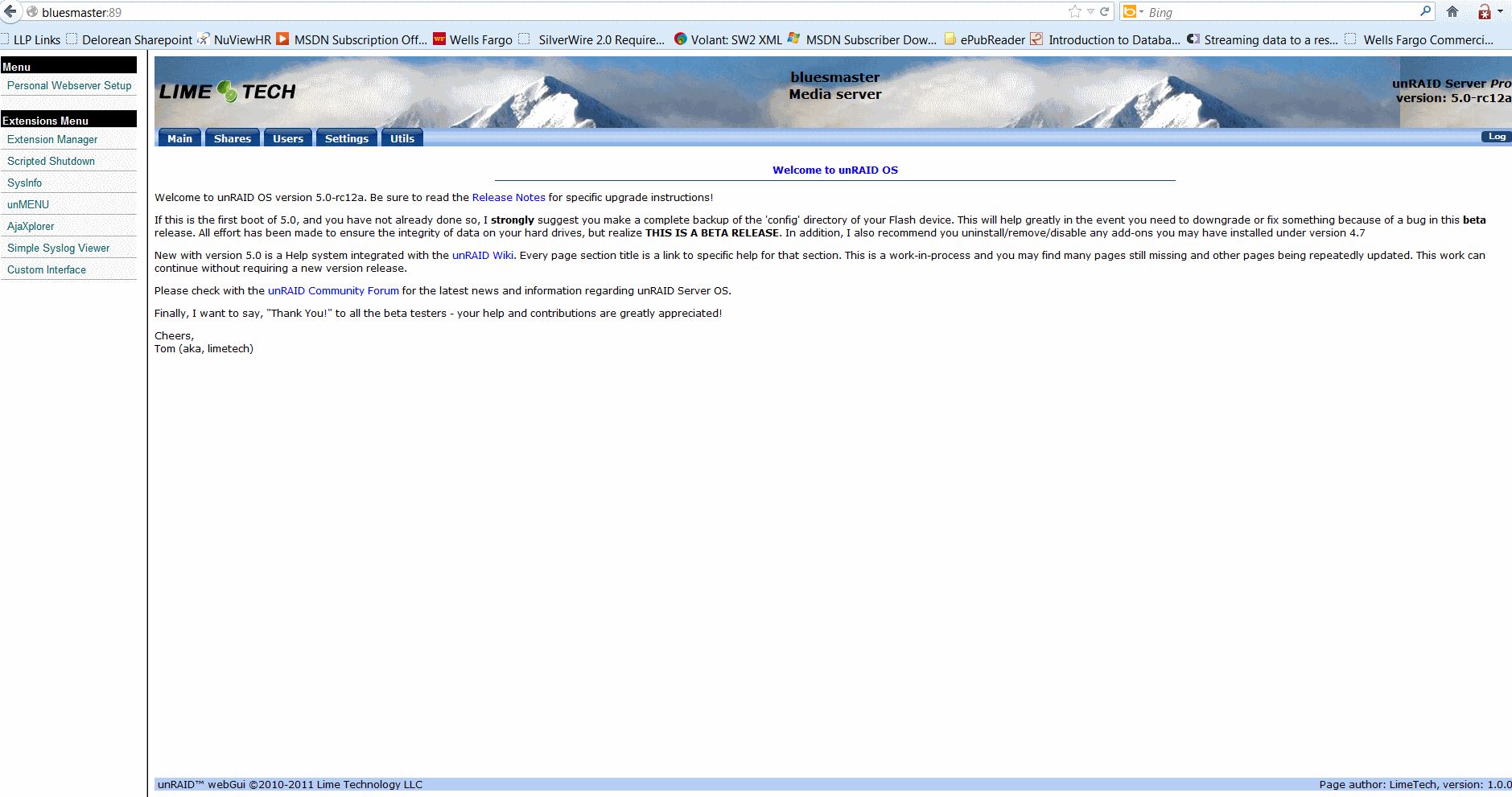

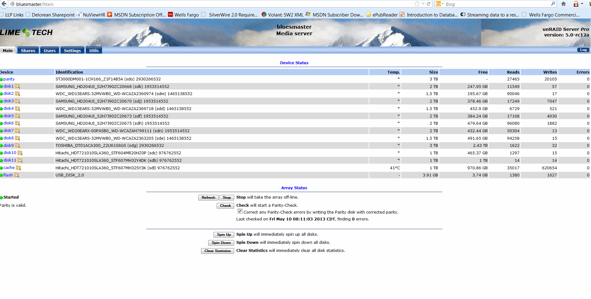

Here is a shot of the unRaid GUI followed by my unidentified add-in.  If anyone can tell me what it is, I'd appreciate it.
That is the standard web GUI (as far as I can tell anyway) so that would confirm no simple features.  Unless you can make it look like the standard which I doubt since the whole idea was to improve the look.
That is unRAID-Web.  You can use the package manager in unMENU, then select that package, and disable re-install on reboot, then reboot and it will be gone.
Thank you for the info.  When I look in package manager in unMENU, it shows unRAID-Web as downloaded but not installed.  Any chance you could point me in the right direction to figure out how to remove it manually?  (I tried "installing" so that I could "uninstall" it, but it halts with a warning message and does not complete).
You are fine as is. Downloaded but not installed means the file is in the correct folder, but it is not currently running, nor is it set to reinstall itself on the next boot. If you want to delete the file so it no longer says downloaded, you certainly can, but it will do nothing except free up a few KB on your flash drive.
Before I did the restore to stock steps, it was running - even after I had upgraded to rc12a.  I found the package for it and deleted it.  Now I don't see it when I access my tower on port 89.
