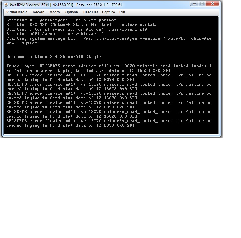

just checked the server and found these errors at the command prompt....  doesn't look good

(1)  Reseat the cables for Disk 1 and try the parity check again (or just try to access it and see if you can read the contents okay).    The errors you're seeing look like Reiser file system errors -- you need to run a reiserfsck check on it ... you need to wait for a Linux guru to advise you on how best to run this.  [Or read the details here and be VERY careful:  http://lime-technology.com/wiki/index.php/Check_Disk_Filesystems ]
(2)  You should be able to read the contents of Disk 1 even if it's not able to provide that data => the fault tolerance will "take over" and the data will be reconstructed from your other disks and the parity drive ... IF the parity is good (thus my first question).
In any event, if you don't have backups of your data (you SHOULD, of course), then you should definitely back up what's on Disk 1 NOW before proceeding.
... just to be clear, I'd backup the contents of Disk 1 BEFORE running the reiserfsck tool on it.  While reiserfsck shouldn't cause any data loss, I'm always VERY careful before doing anything that may alter the contents of a disk that contains data you need to recover.
