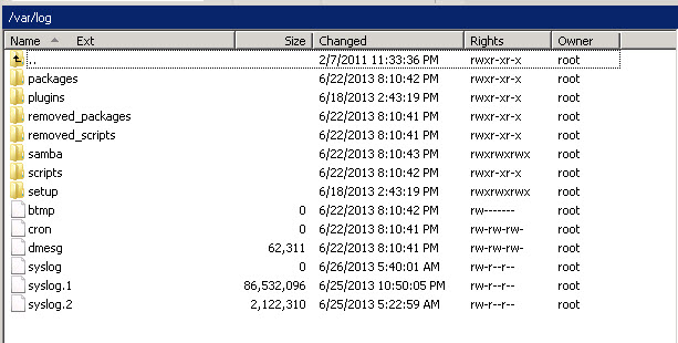

I ran mount -t tmpfs tmpfs /var/log -o size=256m,remount
I didn't bother with the 'touch' as the syslog file (0 kb) was there ready and waiting (see screenshot before I ran a remount)
just ran /etc/rc.d/rc.syslog restart
Syslog back and running. Thank you both.
