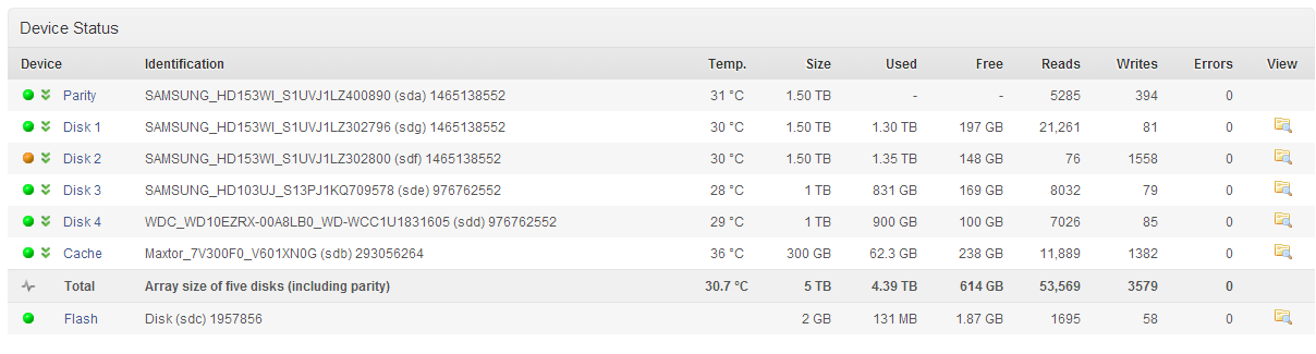

I've attached the drive list, Parity and Cache are attached to the motherboard, drive 1 - 4 are attached to an aoc-saslp-mv8
parity, cache, drive 1 are in the first enclosure, drive 2, drive 3, drive 4 are in the second
Drive 4 failed first, then drive 1, now drive 2.

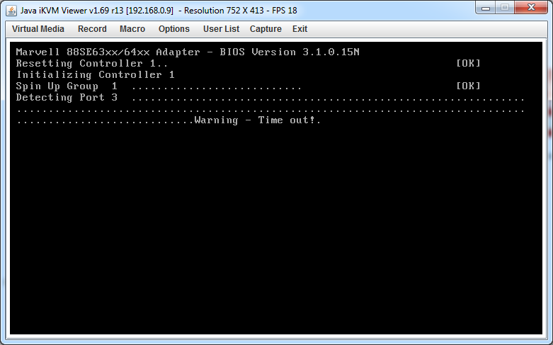

*sigh* Might not have been the enclosures that were the issue, it was playing up again today so I rebooted it and now it wont boot, i just get the attached image, so it looks like the issue might be with the saslp-mv8, i've tried reseating it, putting it in a different slot, reseating the cables, it just won't boot =/
actually, it might be one of the cables, is I remove the one in the first port it will boot up =/ or at least get to the unraid selection screen, havent let it go further than that let
I have seen that behaviour with a bad cable (or one badly seated).    It seems to be due to the fact that the system is detecting a device seems to be present, but then cannot get a sensible response.  Having said that there could well be other causes such as a power problem that might give similar symptoms.
I think in this particular case the issue may have been the drive on that port, annoyingly it was the WD green drive I bought to replace a different drive, with the drive in it was making odd noises and wouldn't boot, with it removed it booted fine.
