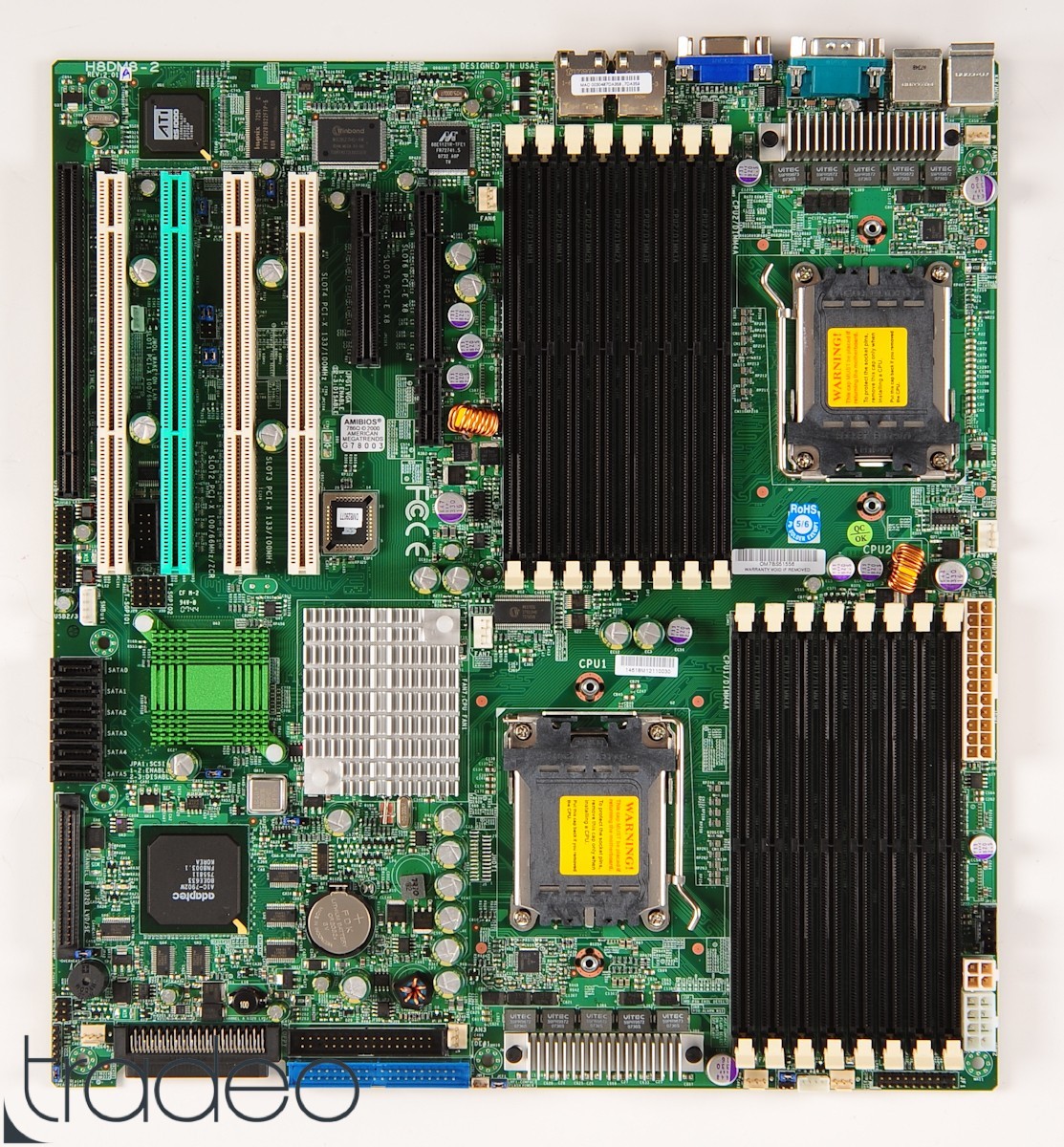

check out this image. shows JWOL near the green slot. can only imagine JWOL stands for Jumper WOL.
From page 2-13 of the manual
The Wake-On-LAN header is designated JWOL. See the table on the
right for pin defi nitions. You must
have a LAN card with a Wake-On-LAN
connector and cable to use the WakeOn-LAN feature.
(Note: Wake-On-LAN from S3, S4, S5
are supported by LAN1. LAN2 supports Wake-On-LAN from S1 only.)
I don't think the JWOL jumper has anything to do with the on-board LAN adapters.  It's apparently to provide standby power to a LAN card with WOL support, so it can monitor the network for a WOL packet and send the appropriate signal to the motherboard.
