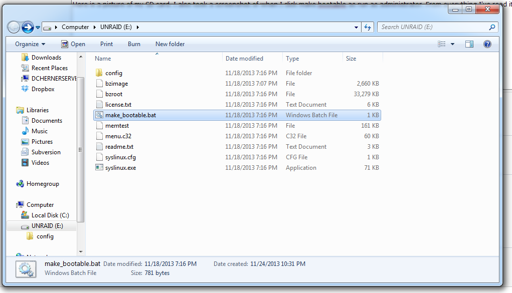

Ryanth, could you show a screenshot of the USB contents (Windows explorer) from the root of the drive.

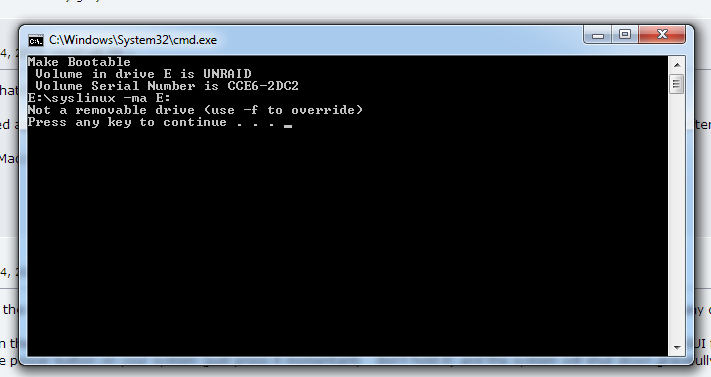

Here is a picture of my SD card. I also took a screenshot of when I click make bootable as run as administrator. From everything I've read it looks correct.
You DO, I presume, mean your Flash drive -- not an SD card ... right?
It looks like you've copied everything to it okay.  But apparently Windows doesn't recognize this drive as a removable drive ... note the error message you're seeing on the Make_bootable screen.
Edit the Make_Bootable.bat file on your flash drive to add the -f parameter at the end of the syslinux line near the end of the file.
e.g. instead of this:  %~d0\syslinux -ma %~d0
you want this:    %~d0\syslinux -ma %~d0 -f
Yes I meant USB.
But that fixed it! Thank you!
