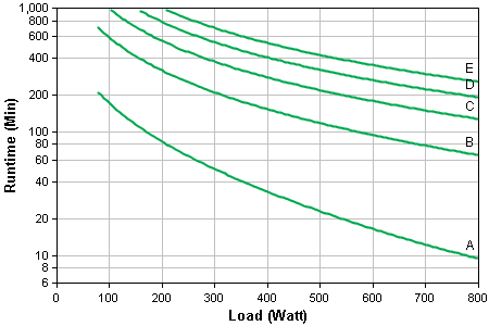

Wattage  is simply a measure of instantaneous power capacity.  This UPS will provide enough power to run a 865 Watt device until the battery dies.... How long the battery lasts depends on an additional piece of information.
Watt-Hours is a measure of both power and time.  So this UPS can run a full load (865 Watts) for 3 minutes.  That means you get 44 Watt-Hours of capacity running a full load.    A half load gets you more, since the batteries won't be hit so hard (you lose efficiency draining a gel cell so quickly).  It takes battery pack APCRBC124 which is 24 Volts at 9 Amp-Hour.
The 1500 APC SmartUPS has a 24v at 18 Amp-Hour battery pack.  You do the math.
Of course, the battery pack is 4 times the size of the small battery in the BR1500G.
A rule of thumb.  Between 2 UPSes running the same load, runtime is proportional to physical size of the battery.  Twice the runtime means you need a battery twice the volume of space.
