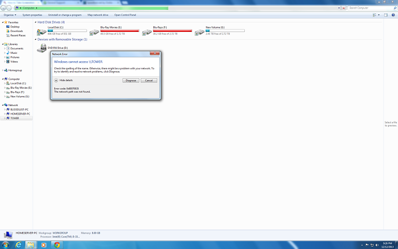

Here's a screen.  You can see "Tower" is showing in the network.  However, If I double click or attempt to expand to access here's what I get.
On the same screen Click in the text field at the top with the horizontal green bar where it says "Computer". Enter "\\192.168.1.3" (or whatever the current IP address is) and press return.
