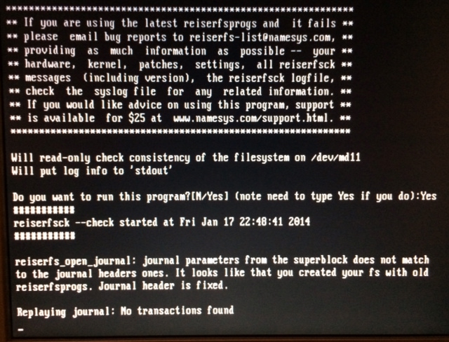

Now I did really type reiserfsck --check /dev/md11
It says: Journal parameters from the superblock does not match to the journal headers ones. It looks like that you created your fs with oldreiserfs progs. Journal header is fixed.
And then: Replaying journal: No transactions found
Like you can see on the picture.
Disk 11 and disk 12 are freshly added empty disks. They both have been written with zero's. They were never part of the array, so I don't understand why it says I created the filesystem with old reiserfsprogs. They showed up unformatted in the GUI some posts ago and that's it.
The console seems to be doing nothing now for an hour, what should I do next?
If the drives have never been added to the array and then formatted then there is no file system and any reiserfsck output should be ignored.
