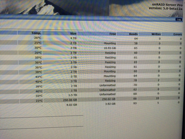

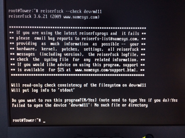

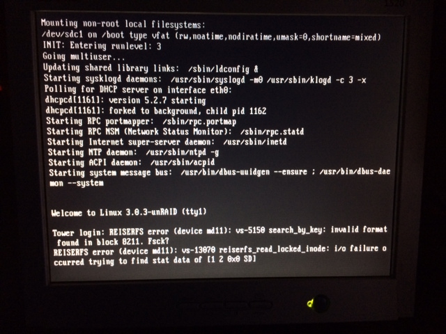

In a last try to get my system going before buying a new MoBo, I managed to disable the raid functionality while keeping the .21 firmware as described here: http://lime-technology.com/forum/index.php?topic=27129.0
What I got in return was a nice line of harddisks in my bios, just like it should but which I had never had before with 14 attached drives!
So now I'm kind of convinced that the problem IS fixable after all..
The problem is still the same, after booting up I saw all the disks as you can see in picture "GUI". The three disks that I added (at once) are all visible as unformatted, and disk 12 has a red ball (because I tried to remove it some days ago to see if the system would start up with one disk less. It didn't, but the result was a red ball when installing the disk again).
When I start the array, nothing further happens. Except for the screen on my server as you can see in picture "Problem" (next post). Some problem with device md11, i/o failures???
Everything stops after that, there is no further activity.
Anyone know how to act now?

Here's the picture from the last post
The error showing from your screen shot makes me think you have file system corruption on md11 and you need to run the tools to fix them.  However I'm not the person to advise you on this as I've only had to use them once so am not familiar with them.  Maybe someone else can take over now I've reached my knowledge limit.
Thanx BobPhoenix,
Maybe someone knows how to solve this puzzle
Thanx dgaschk!!
I will try and give this a try tonight and post the result.
Ok, I started the array in maintenance mode. I quickly stopped the data rebuild that it started by itself because of the red ball on disk12.
After typing reiserfsck --check /dev/md11 on the server, I got the screen you see on the picture. It does that with all disks.
There is a missing leading / on the device name (e.g. /dev/md11).
