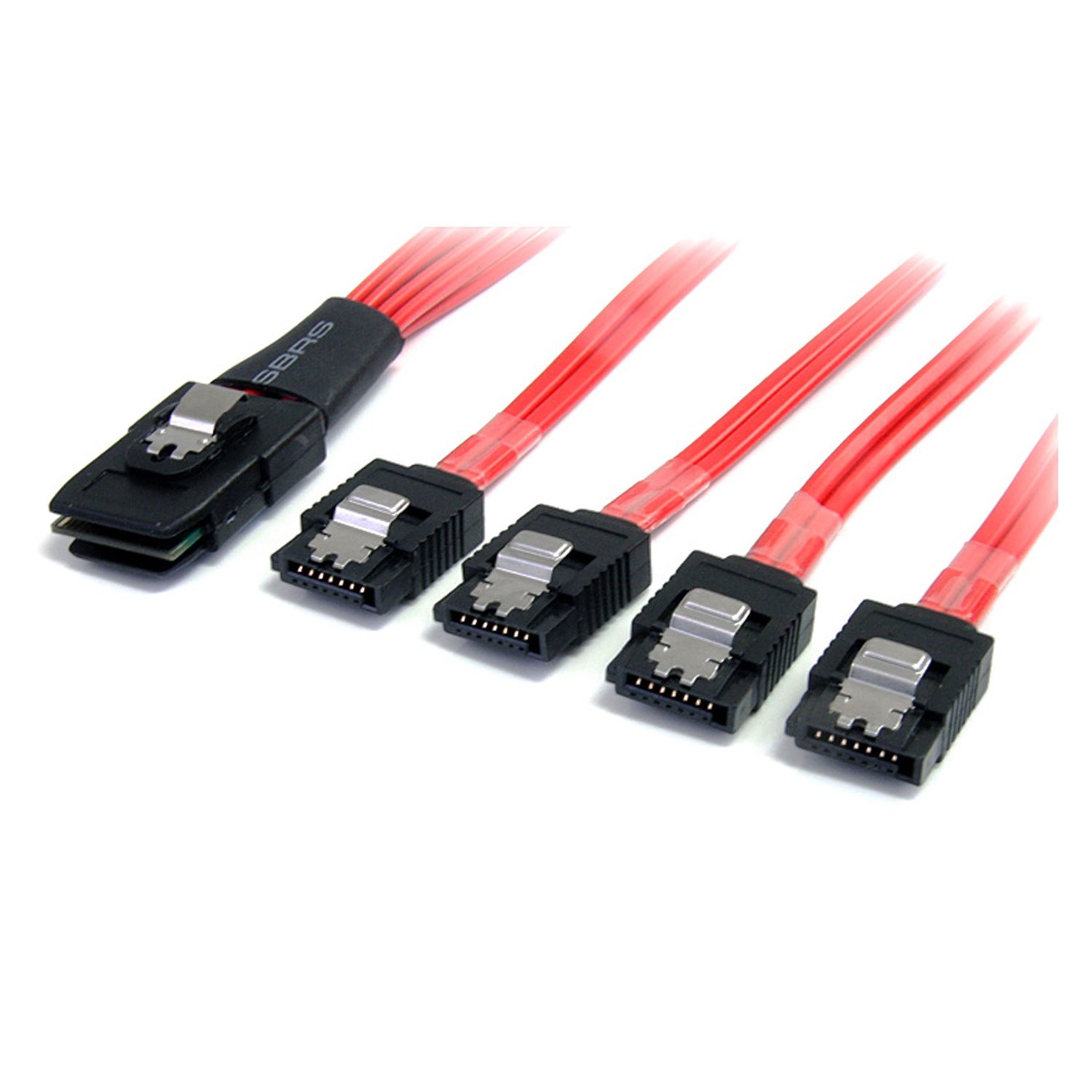

I will try one of those M1015's, (or the AOC-SASLP-MV8) if you think that will do it. Do I need any special extra cables with that? It's not that simple to just stick my old SATA cables in that card I think?

Yes. The SAS card uses different cables.

As you've already noted, you have to buy SAS-SATA breakout cables to use the cards I suggested.
FYI: The cable you are showing in your graphic looks to be a SFF-8484 to 4 SATA cable which is what came with my SuperMicro 4 x 1 laptop drive cage(http://www.newegg.com/Product/Product.aspx?Item=N82E16816101190).  The M1015 requires a SFF-8087 cable connector which is what ScubaBart's link looks to be.
Absolutely right, BobPhoenix.
I fixed the graphic.
