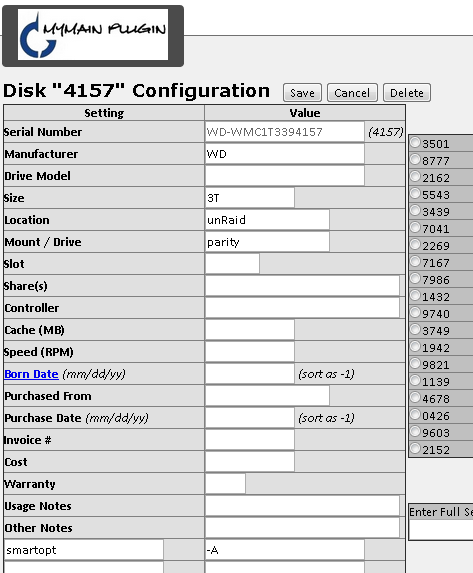

You could modify the correct awk files like I did at first.  Or you could click on the drive ID link (graphic 1) and add "smartopt -A" (graphic 2).

Unfortunately I had already done as you suggested.  I added the "smartopt -A" to the "My Main" "Disk Configuration" page.  This did allow for me to see the temperatures in My Main, but it does not seem to carry over to the unMenu "Disk Management" page.  The two pages must be getting their configurations for arguments from different areas.
