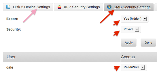

Accessing the disks directly:
Click on the disk name (disk 2 in the example)
and set the permissions that you want.
My example of my disk 2 shows 'hidden', so that its not normally advertised....I have to deliberately type in the name of the disk. And 'Private' so that Userid and Pswd is enforced so that only I can access the disk directly...everyone else should be using the 'user shares' interface.  Your setup may vary.
(Also, this is screenshot of the Dynamix web interface...the stock interface is similar.)

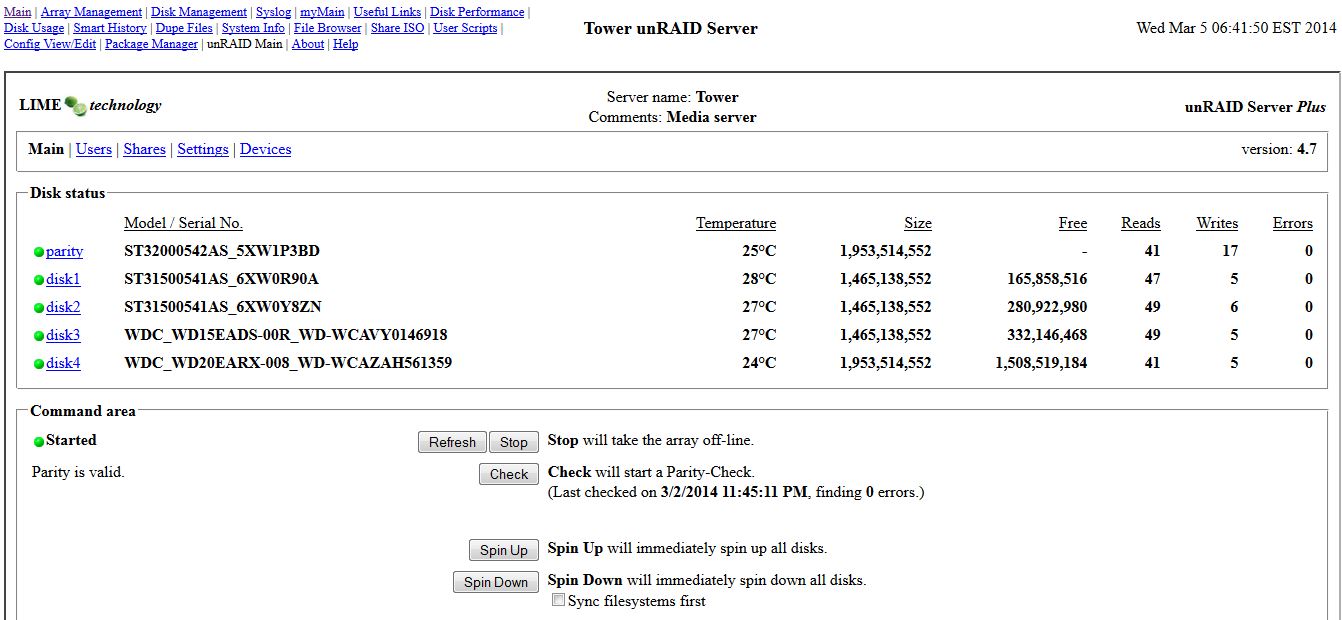

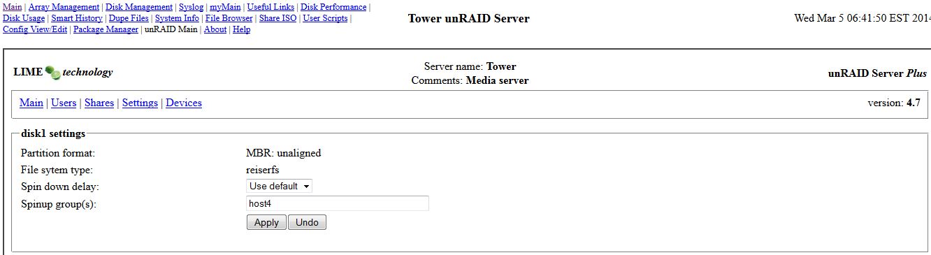

When I click on Disk1 for example, I do not see the options you are talking about.....
Oh! sorry, I thought you had already upgraded to 5.0.5.
The security model in 4.7 is different...
Perhaps someone else will remember how to get there from here.
If I remember correctly you need to go to the "Devices" menu.  But I could easily be wrong as it has been a LONG time since I had 4.7 installed.
Click on Shares, the top section is Export Settings, make sure Disk shares (SMB): is set to Export read/write.
Cool.........found it, and it works
