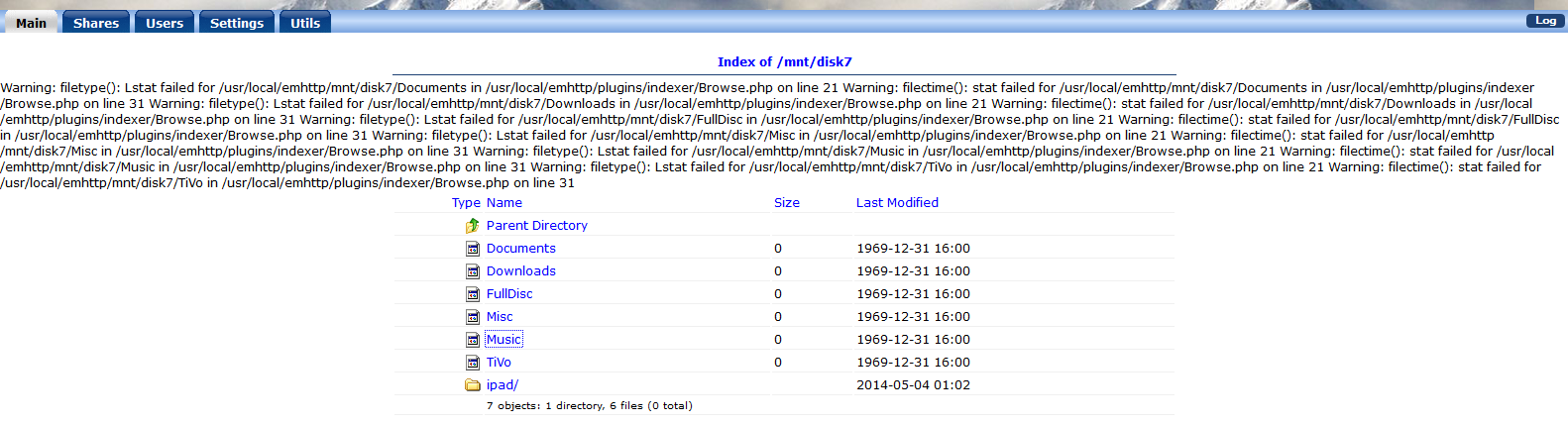

Please see attachments.
Wanted to remove four similar drives and add a one-off (removal was to ease system slowness due to older SATA controller which I also removed)

symptoms include no Webgui shares and no UNC shares and current shares cannot be re-created. I can access shares from each drive
I have the old drives handy and a screenshot of the original config.

I could read/copied the files but they all said 0kb.

Seeing lots of permissions errors in your syslog.  If you open up mc and browse to each of the drives individually, what does chown report the permissions for each folder as?  Root:root or nobody:users?

P.S. At the terminal windows, I too am seeing stat permission errors when I try to access the folders.

OK, I ran Select Utils->New Permissions with no luck.
