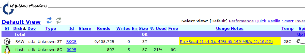

Technically it is in MyMenu (part of unMenu) see attached graphic which is from my preclear station.

Am I correct in assuming Screen is what sends the preclear update to  the Unmenu dashboard?
No.  It allows you to disconnect the telnet session and have the preclear process continue.
It has absolutely nothing to do with unMENU's mymain plugin monitoring the progress.
