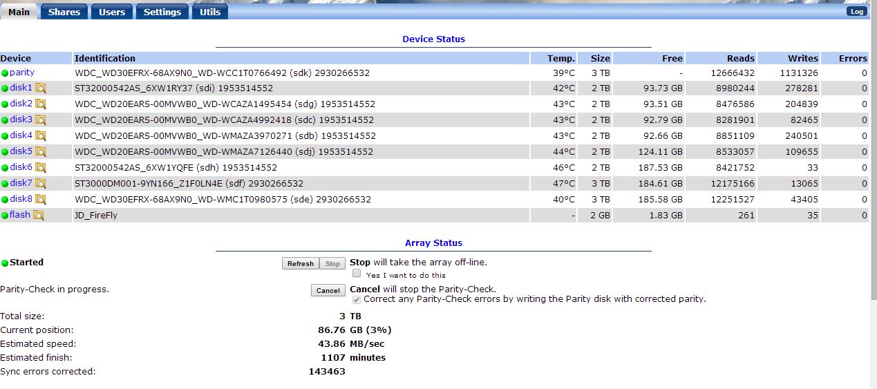

July 2, 201412 yr How can I tell what is causing my parity errors? I had a bunch so this is a screenshot of me running my second parity check. Server has been solid for a cpl years no issues. Will run a memory check once this parity check is complete. I stopped the correcting after this didnt notice it was on. hal.txt smartdisk.zip

July 7, 201412 yr Author Cleaned computer out, re-seated cables , replaced parity drive cable still getting errors on check. What are my options for tracking down the faulty drive? Don't understand why the logs are not configured to tell me what drive is reporting different than the parity drive. syslog.txt
July 7, 201412 yr If you did have a cabling problem while it was doing a correcting parity check, then maybe the parity was "corrected" and is now wrong. Are you using locking SATA cables? Maybe a power problem? Try a couple or more non-correcting parity checks and see if it gets the same number of errors each time. If not then you still have a problem.
July 7, 201412 yr Author Was 150 errors last full check now its at 136 errors at 1% checked. If i'm adding files to the array during a parity check will that cause errors? I just ordered 3 4TB drives to swap for some of the 2TB in the array. Should be here Wednesday.
