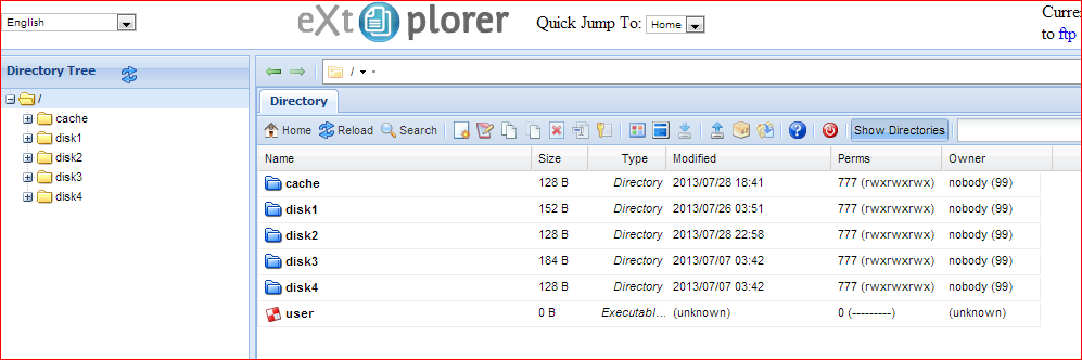

Using AjaXplorer 2.3.9 - 2008/12/17 that came with unRAID-Web
I cannot navigate to /mnt/user (the account has admin rights in AjaXplorer).
I could still go to /mnt/diskx/... but that is cumbersome, I would have to find the right disk first to locate the file. It would be much better to be able to use /mnt/user/....
Any thoughts? Anything wrong with my installation?
Thanks for caring,
JC
JC, I'm curious - did you manage to solve this problem? I'm using the simplefeatures webserver plugin and sgdisk doesn't complain about any missing libraries and I have this same exact problem.
I tried eXtplorer (v2.1.0) and it has the same issue - can't access /mnt/user
I want to fix this but I don't know how...  (T-T)
Does anyone know how to fix this?
