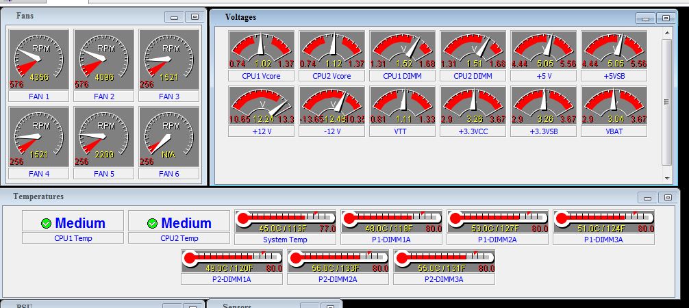

The picture is of what all the fans at 100% look like with no load. (I did not have the fan on the raid cards at that given time).
i think you need better cooling for your CPUs - maybe, if they will be cool, then other fan's will not jump so high in RPM... but that is a guess only..

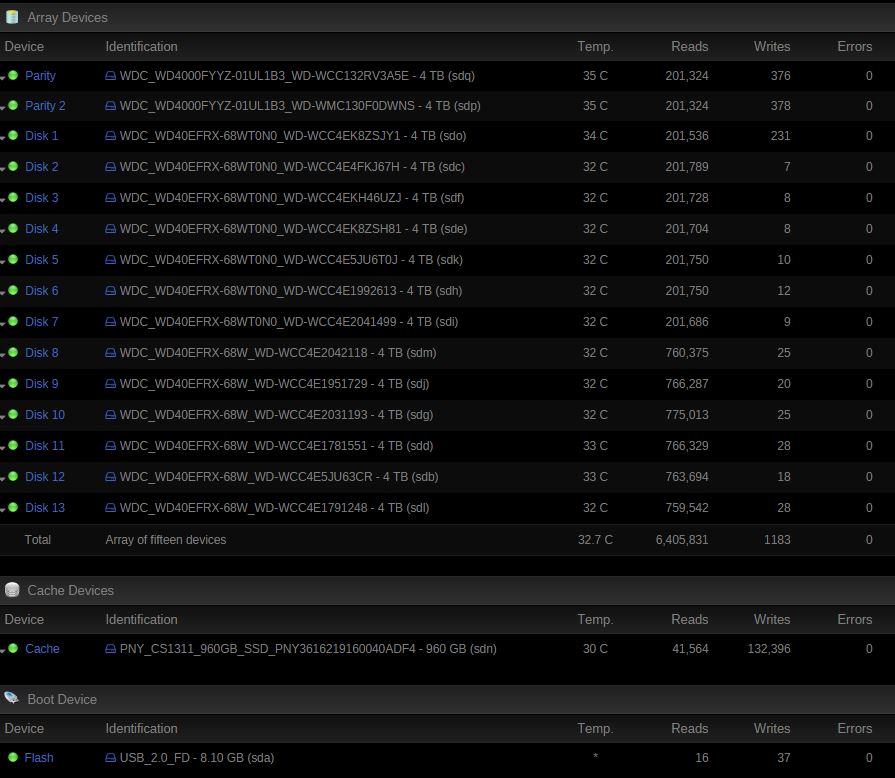

23 hours ago, demonmaestro said:
4U case - at idle. 75-76F ambient temperature
Sorry I know this has spanned a couple of pages...
That is the temps at idle.... and the HDDs spun up.

Interesting -- the temps are much higher; but also the fans are spinning at MUCH lower RPMs than in your "idle" picture about 9 posts ago.
Are the fan speeds now being controlled by the Corsair Commander?    If so, perhaps you need to adjust where you have the thermistors so the fans ramp up more when the system is under load.     Or perhaps raise the minimum fan speeds.    I suspect if the fans were running at higher speeds your temp problem would simply go away.   And with these Noctua fans, they'd probably still be pretty quiet.

So the picture a few post back was from doing a parity check. For whatever reason when I had started the Parity check it spun up all the fans to max even though the cpu loads where at 2-3%.

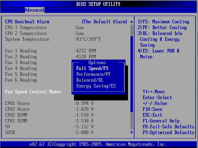

I had looked into the bios and was presented with 4 options
  • Full Speed
  • Performance
  • Balanced
  • Energy Saving
Come to find out it was on Energy Saving. HOWEVER I had tested it via the "fur mark" CPU test and with both CPUs at 100% load the fans were not spinning up. So I think the options is just preset voltage levels and not fan curves.

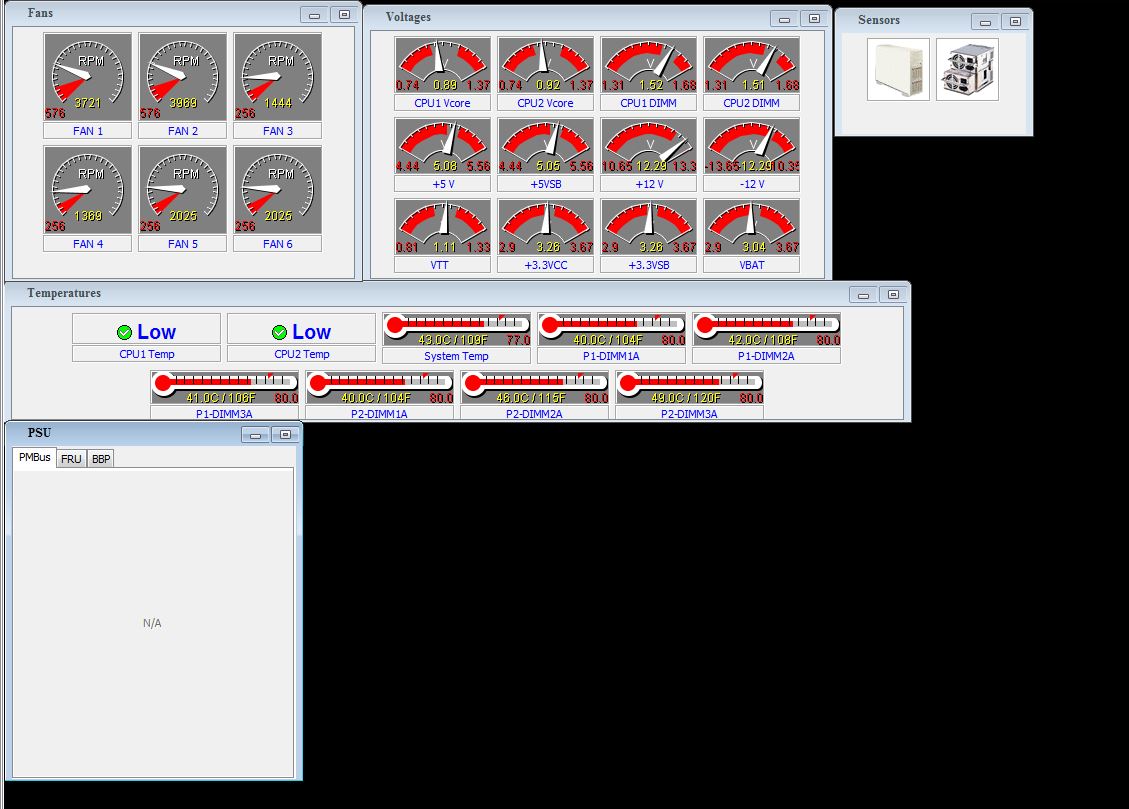

I had set the fans to Full Speed and ran the CPU test for 20 minutes and a parity check to load up the drives. The pictures below is the results of the temps.
Not too bad I think. Also the CPUs had went back to low little less than a minute after stopping the test. So it must of been in the lower temps.
So not sure as to what to do. Maybe the CORSAIR Commander PRO will help out somehow.

The temps all look great with the full speed setting.    That's probably more aggressive than you really need.   I'd try the Performance and Balanced modes and see how they work.     You may not even need to bother with an external controller :D.
What's the noise level with full speed?      Ideally you'd like a setting that does a good job of cooling without blasting you out of the room from the fan noise
Well I had tested on all settings and "Balanced" is just a hair too much noise for my liking when idle.
Now full speed while it might not sound like a jet taking off  (like a poweredge 2950) it is WAY too much noise. lol
The issue is it should ramp down the fans when at idle and speed up the fans accordingly with temp/load.
