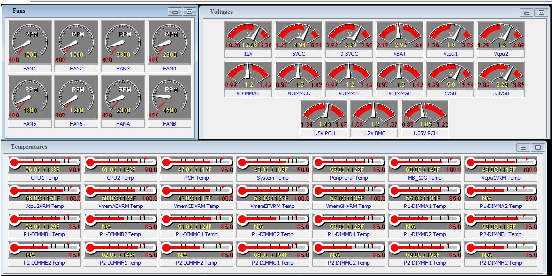

yes, your ambient temp is a bit high, but very close to mine - i have my server in small cabinet with very poor ventilation. if i run stress tests on both CPUs at full speed, then temp are very close to 80 on both cpu, but never throttles.. see my server details on my sig..

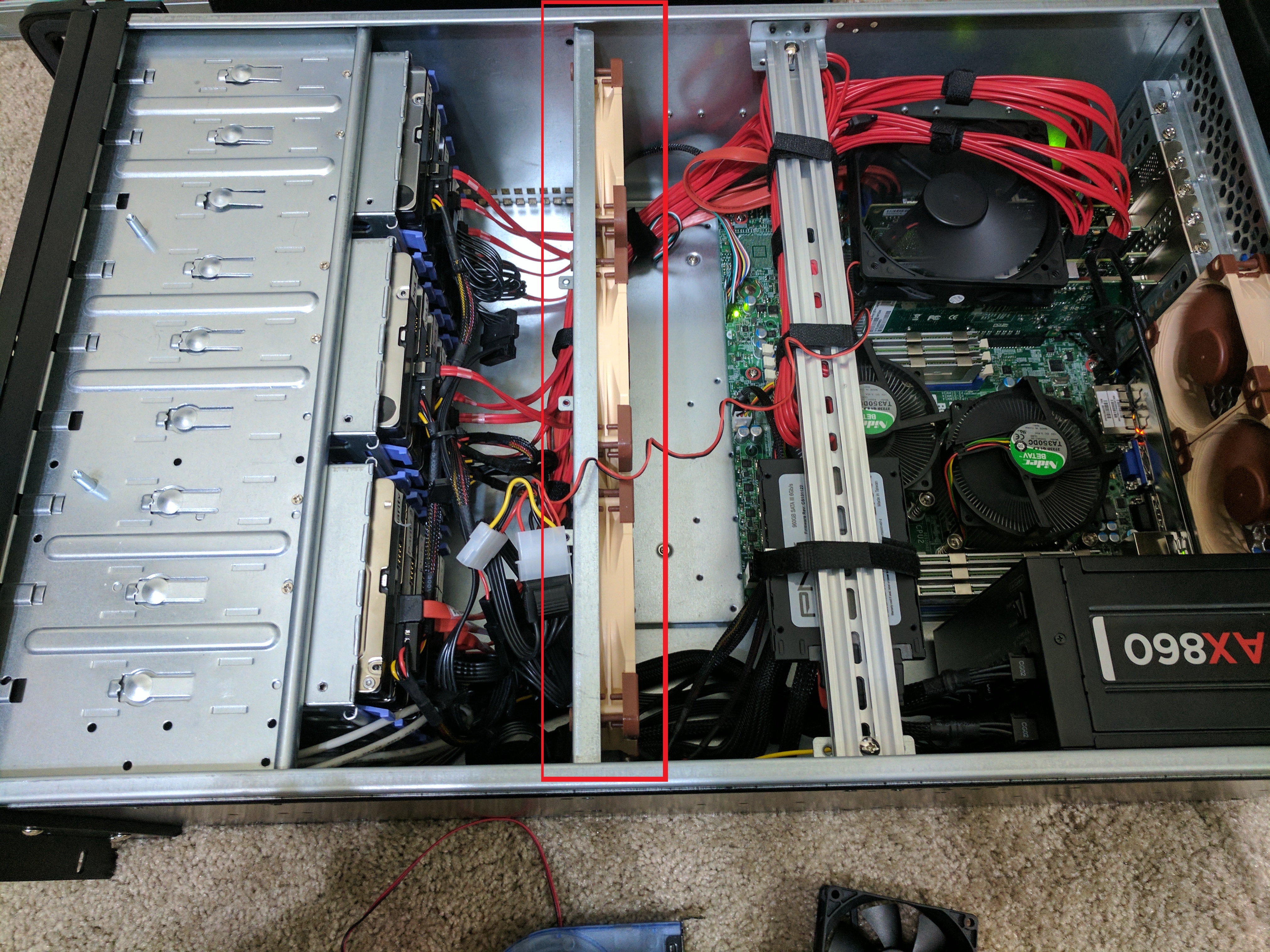

maybe it has to do something with the noctua coolers. I looked trying to figure out how to move it to a front to back setup when I had changed the drive cages out. Maybe I should see if I can stuff the 3 fan rail thing back into the case. But I would think that would block the fans off of the drive cages..

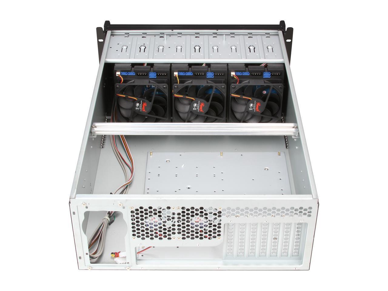

i just hope your 3x120 front vent direction is right, can't see them in your picture :)
you can just test it with open case - air need to be moved inside a case from the front.
according open case - i tested this some time ago on my server - CPU temps was lower than with closed case - i know, this is because ambient temp and my small cabinet with very bad ventilation..

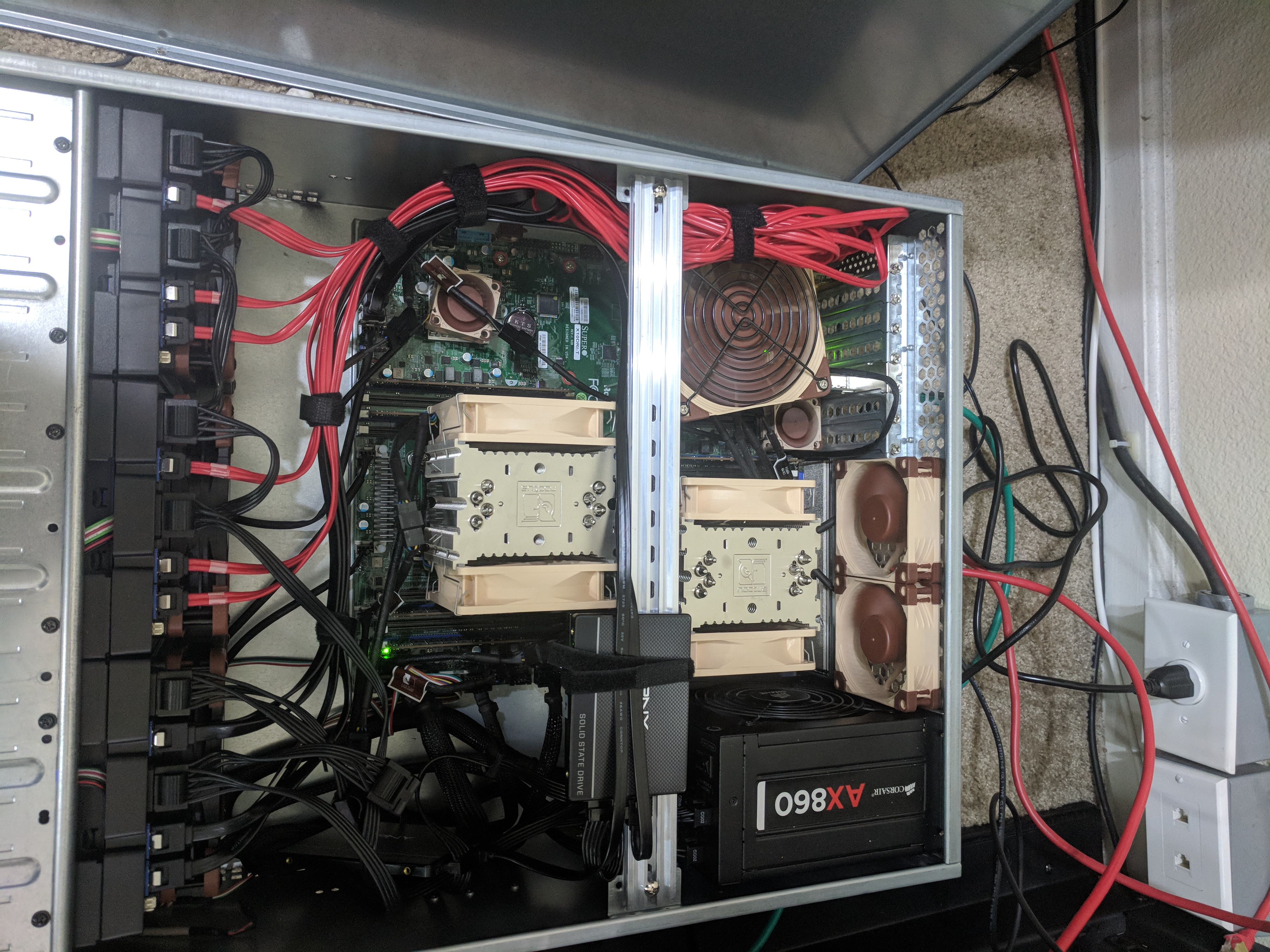

Well heres what I will do unless @garycase  or someone else would recommend a different case all together for my issue. Just keep in mind its a E-ATX mobo.
I will add back in the middle row of fans and max out the CPUs to see what happens.
I know that the original version of this case does not have the mid row of fans .(Rosewill RSV-L4412)
I have the mid row of fans setup because I have converted the case from a Rosewill RSV-L4500 to a Rosewill RSV-L4412.

Please keep ind mind that the picture of the mobo is not the current motherboard setup.

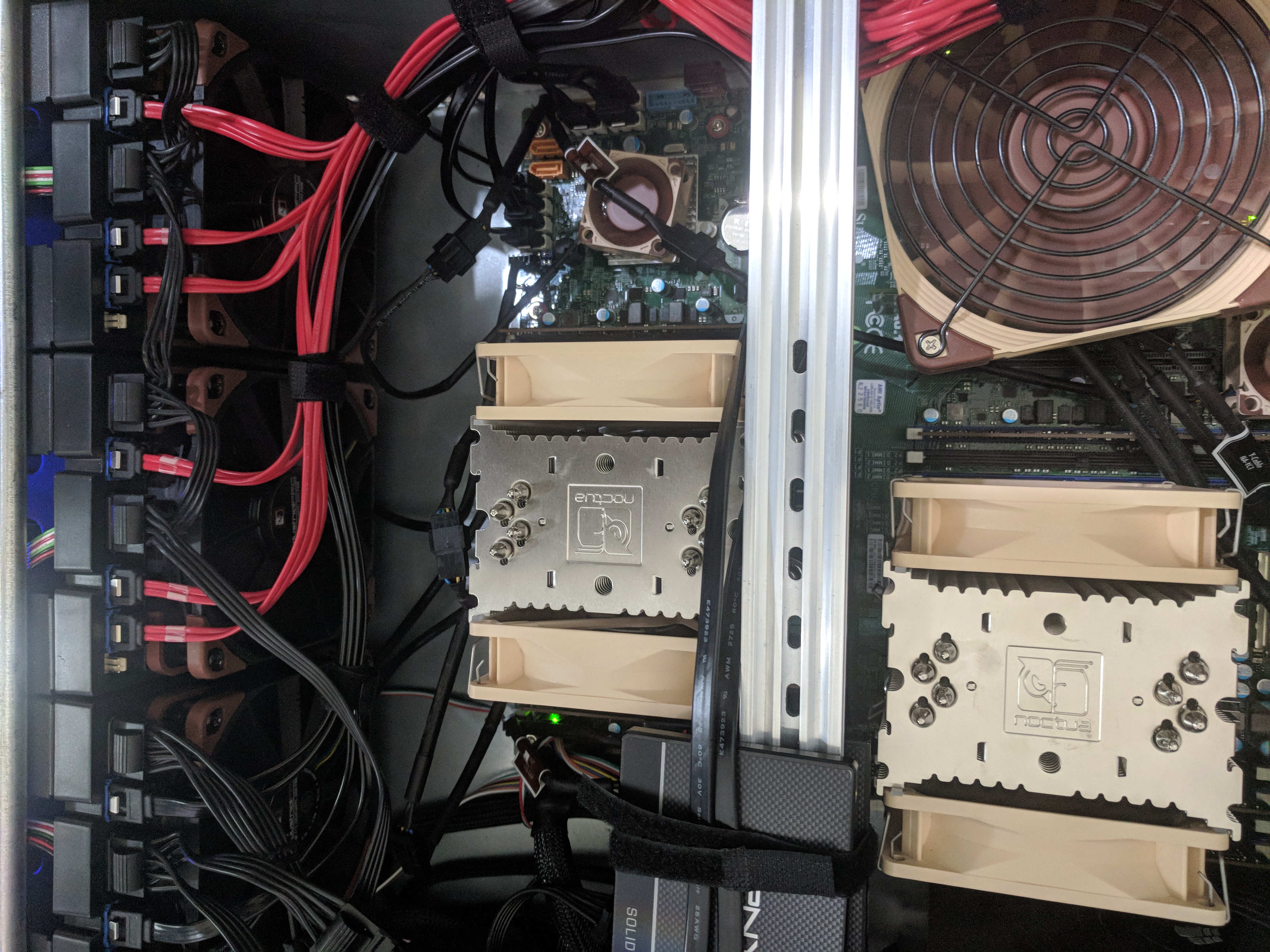

I would really think your current heatsinks should be okay -- but it IS true that the larger fans you referenced have a LOT more airflow than the ones on your current heatsink -- 110CFM vs 38CFM.    Moving that much more air would certainly provide better cooling.    But I really think re-mounting the heatsinks might be all you need to do  [or course if you switch heatsinks you'll be doing that for sure :D]
Adding the middle row of fans may also provide a big improvement -- clearly it will add a lot more airflow.
As I noted earlier, be sure to check the CFM rating for all of your fans and see just how much air they should be moving -- if you're using low-rpm fans that only move ~40CFM that may be the primary issue.

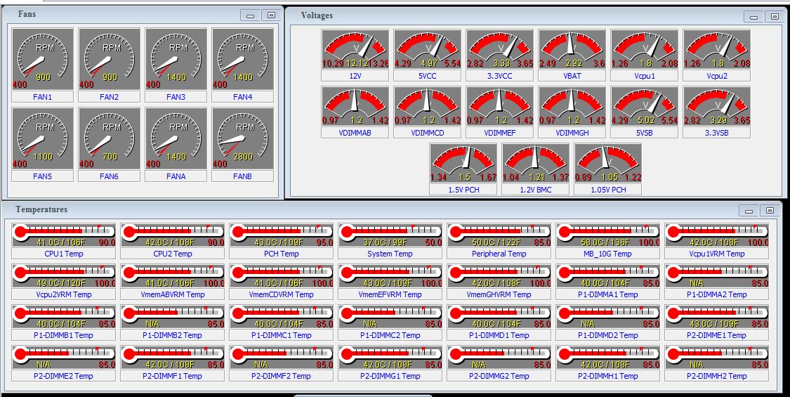

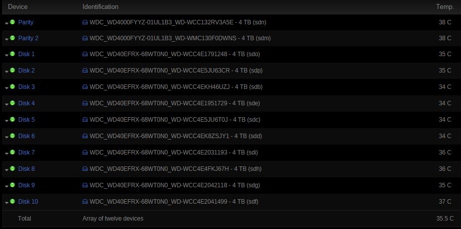

Sooo I had ran the CPUs at 100% with the lid closed but with the new faster noctua fans on the drive cages. Had left the "fan curve" on the supermicro mobo to standard.
The fans never spun up to 100% but kept at a cool 58C on the CPUs. I had the test run the CPUs at 100% and did a Parity check for 4 hours. Below was after 4 hours of being ran at full tilt.
Thoughts?
Looking good => amazing what nearly tripling your airflow (38CFM -> 110CFM = 2.89)  does for keeping things cool :D
