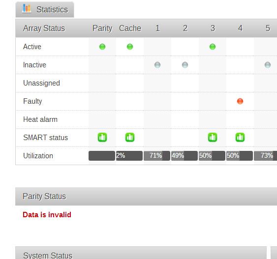

August 2, 201412 yr Author also my Parity Status = Data is invalid - should i run a parity check again before I swap out the dead drive?

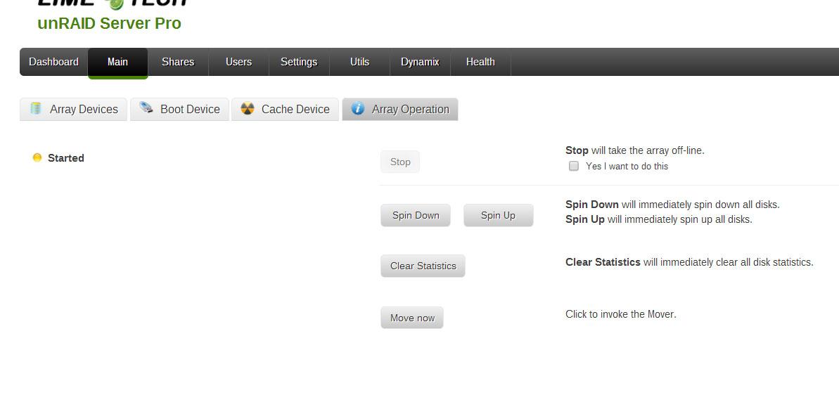

August 2, 201412 yr also my Parity Status = Data is invalid - should i run a parity check again before I swap out the dead drive? Post a screen shot. I am not sure what you are seeing.
August 2, 201412 yr Author After I made the second screen shot, I noticed there is no parity check button. I think its cuz i still have a redball drive in my array.
August 2, 201412 yr After I made the second screen shot, I noticed there is no parity check button. I think its cuz i still have a redball drive in my array. You are running some WebGUI plugin or enhancement I don't use. If your array is started (which it appears to be), and you can see the contents of disk4 (which should be being simulated by parity + all other array disks), then you can rebuild the failed disk. unRAID will not let you start an array in an invalid state. I am not sure what it means that "data is invalid" for parity. Does not make sense to me.

August 3, 201412 yr Apparently you do not have valid parity data -- if that's in fact the case you can't rebuild the failed disk. Before doing anything else, boot to Safe Mode and post what the stock Web GUI shows, just to confirm that's in fact the case. If parity is in fact not valid, then I'd simply do a New Config that does NOT include the failed drive; let it build parity; run a parity check to confirm all is well; and THEN either (a) attempt to recover the data from your failed drive on another system or (b) if you have backups, just copy the data that was on that drive back to the array from your backups.
August 3, 201412 yr also my Parity Status = Data is invalid - should i run a parity check again before I swap out the dead drive? Just to be very clear -- once you have a failed drive (red-balled) you can NOT update your parity. If the parity isn't valid at that point, there's nothing you can do about it.

August 5, 201412 yr After I made the second screen shot, I noticed there is no parity check button. I think its cuz i still have a redball drive in my array. You are running some WebGUI plugin or enhancement I don't use. If your array is started (which it appears to be), and you can see the contents of disk4 (which should be being simulated by parity + all other array disks), then you can rebuild the failed disk. unRAID will not let you start an array in an invalid state. I am not sure what it means that "data is invalid" for parity. Does not make sense to me. In case it would be helpful, I took a look at the source code for the dynamix webgui plugin to see what it meant by "data is invalid". It looks at the output of "mdcmd status" and if mdNumInvalid is NOT zero it then checks the value of mdInvalidDisk, if the value of mdInvalidDisk IS zero it prints "parity is invalid" if mdInvalidDisk is NOT zero it prints "data is invalid".
