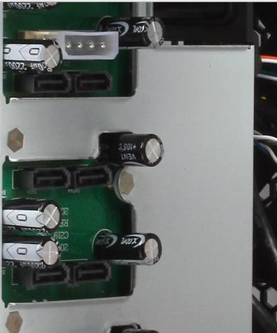

August 5, 201412 yr You should use straight cables 8 - 10 inch. Your sata ports will be directly below and in front of the drive plane. Angled cables won't work well because they will be angled down and have to bend back up to your ports. They also won't work where the molex connectors for the drive plane power go and there are capacitors in the way too. But you can use one for the 2.5" drive, if it's the bottom one.
August 5, 201412 yr Agree ... I found a pretty good picture of the DS380 backplane, and clearly straight connectors will work well there, since it's facing the rear of the case and you don't have to worry about how close the side panels are. As I already noted, you also want straight connectors on the motherboard end as well. So you want cables with straight connectors on each end. I trust that dmacias has measured what works best, so I'd go with the 8-10" lengths he suggested ... perhaps buy a few of each. I've attached a picture of the backplane.
