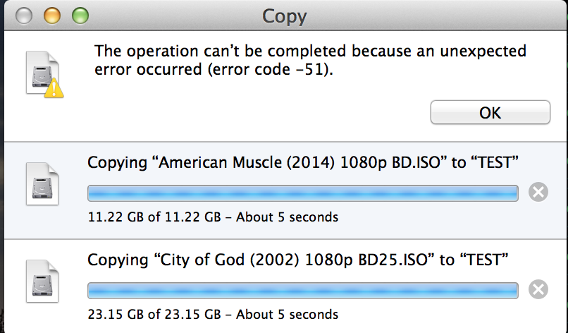

Today, the samba disconnect got worst (see attached). I am also sending you /var/log/samba/log.smb - I turned the 'log level' to 2.
The server cannot complete any of the copied files. However when using scp (Transmit for Mac) no problem at all.

"The operation can't be completed because an unexpected error occurred (error code -51)"
"-51 rfNumErr Reference number invalid"

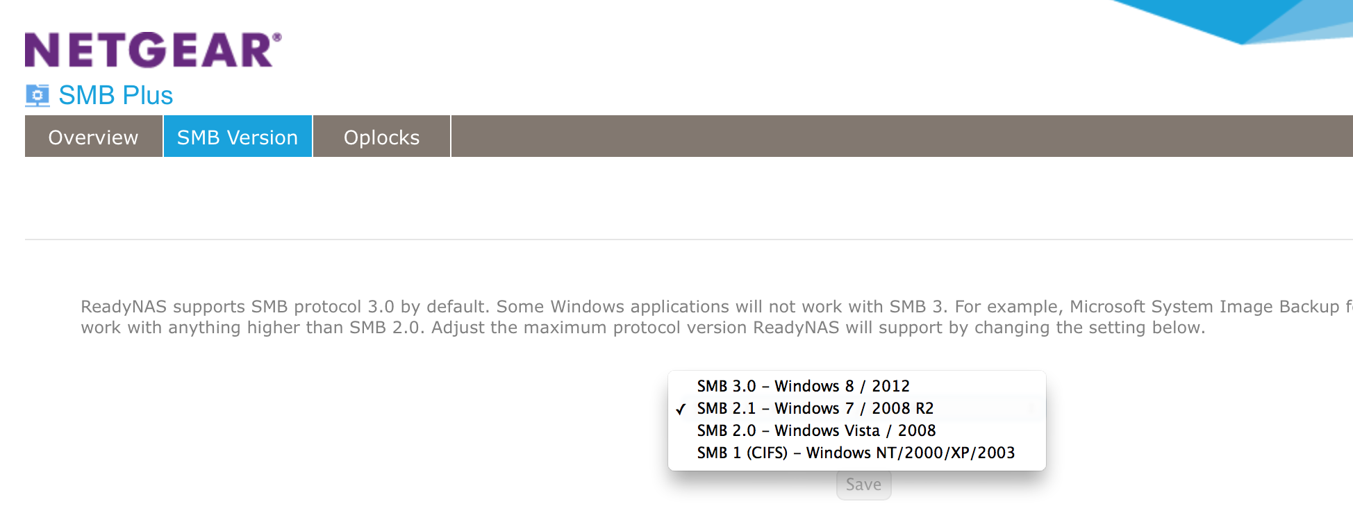

Also, when ReadyNAS OS 6.1.x was released they had the same problem. Netgear released special app called 'SMB Plus' and that solved the problem. (see attached)
