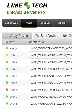

Lately I have been having drive failures. Usually it is a simple read failure. the simple thing was to stop the array, reboot, remove the disk, start in maintenance mode, stop array, re enable the disk, allow it rebuild and then carry on.  Today another drive had a read failure during the rebuild process.  What do i do to not loose any data that is on the disk that was in the process of being rebuilt?  I know the data is good on the other disabled drive and parity is still good.
Have you just been rebuilding without ever really getting to the root cause of your problems? How do you know anything is good? Better post a syslog.
Sorry - just saw that i posted in the wrong section. Running 5.0.5
Your syslog wasn't any help, as it involves a boot but the array is never started, so no failed disks and no disk errors.  We need to see a syslog where a drive fails.  He's right that you need to find out the root of the problem, because often it has nothing to do with the drive itself.  It could be as simple as several faulty SATA cables.  We'll know better when we see the errors in the syslog.
BUT FIRST!  The syslog is over 16.5MB of UnRAID refresh, repeating the drive inventory and array setup every single second that the array is offline!  This is something that is caused by your old version of Dynamix, v2.2.3.  Please upgrade it as soon as possible to the latest.  Then reboot again and start the array.  Once you have a drive fail, then capture the syslog, zip it, and attach it here.
Thanks for the suggestions. I have done a few things. Since the issues started ive replaced the motherboard, cpu and RAM. Last night I also installed a second PSU to assist in power load balance.
I know the data is good as i have done several parity checks and reiserfschk and all have come back clean. Starting to think it may be a cable issue. I am using 2 supermicro SAS controller cards with sata breakout cables. Link to controller below.
I think what i need to know right now is how can i tell the system that Disk 6 is ok so i can finish the data rebuild on disk 1. I will attempt to get the breakout cables replaced over my lunch hour and try to get Dynamix updated as well.

I think i may have a drive issue... smart doesn't look good for this drive.
smart.txt
sdc.txt
root@10:~# badblocks -o /tmp/sdk.badblocks -sv /dev/sdk
Checking blocks 0 to 2930266583
Checking for bad blocks (read-only test):  2.31% done, 7:19 elapsed
will post up when thats finished.

Here's where the trouble lies.
In any case, if you do not have a backup you can try to use dd rescue to copy the drive forward and back to see what it can save.
Let's see what SMART reports after the badblocks read test.  Keep in mind the firmware and the kernel will do retries.
So bad blocks alone cannot detect a bad drive, you have to review the syslog and look at the smart reports.
Device Model:    WDC WD30EZRX-00DC0B0
Serial Number:    WD-WCC1T1339998
196 Reallocated_Event_Count 0x0032  197  197  000    Old_age  Always      -      3
197 Current_Pending_Sector  0x0032  199  199  000    Old_age  Always      -      674
198 Offline_Uncorrectable  0x0030  199  199  000    Old_age  Offline      -      604
Checking for bad blocks (read-only test):  14.80% done, 47:38 elapsed
done
Pass completed, 43 bad blocks found.
sent the smart data off to WD - they are going to RMA the drive.
Smart report after badblocks
smart2.txt
You'll see that current Pending Sector count went up.
So more sectors are bad.

Doing and advanced RMA and will be purchasing an additional drive. will back-up the data and replace the drive BUT i still need to correct the overall issue of restoring data to the other drive that was in the middle of a rebuild when this error occurred.
Is the 'other' drive still functional? or is it totally gone now?
The data is gone as it was in the middle of a rebuild when drive 6 threw an error. If i can get drive6 to be happy again, i know that drive1 could finish its rebuild.
I'm not as confident that his parity and drive 6 are OK as he is.
And I don't know if this would work or not so someone else chime in.
Could he set a new config and check the valid parity box, then start the array.
Stop the array and unassign drive 1. Start the array so it sees drive 1 missing.
Stop the array and assign drive 1. Would it then be able to rebuild?
That is exactly what I was thinking but I felt it all a bit above my head so i had to come here first.
Did the drive totally die and is in operational? Does it spin, can you grab a smart log?
If the drive spins and a smart log is accessible, maybe you can just dd rescue the data and try to do reiserfs repairs on it.
Help me understand.
Drive 6 is the one with the pending sectors (read failures)
Drive 1 was having other trouble?  Is this still alive or is it totally dead.
