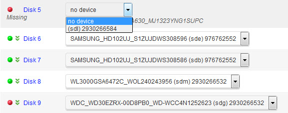

I'm looking at 2 red-balled drives, one has a drive in the box, the other says missing disk.  I've checked the cables twice, and the third time I moved the drives around, to connect new/different SATA and power cables to both drives.  The errors followed the drives, so I doubt it's a cable issue at this point.

My son started watching a movie, and it was stuttering frequently (not an uncommon occurrence unfortunately), but I suspected it might have to do with disk10 being sketchy, so I shut down the server, and checked all the cables.  I remembered I had a new drive sitting 'loose' in the server from when I had the last red ball, about 2 weeks ago.  I removed the old red-balled drive from its caddy, and put the new drive in its place, checked all SATA and power cables, and started the server.
I ended up with 2 red-balled drives, one as missing and the other listing the drive.  I shutdown, moved the drives around, and started again.  red-balls followed drives.

From your syslog and the image, it looks like the disk listed in the drop down is the same serial number as the one it says is missing on disk5.  Can you assign that disk and it show up as the correct disk before starting the array?
I couldn't assign it.  When I selected it, it just didn't 'accept' that.
I finally decided that rebooting one more time couldn't hurt, and when I did, it found that disk, and added it just fine.
Now, I just have the one red-balled drive, disk 9.
That allowed the array to start, so now I'm moving all the data off of disk9 to the other disks, and will try to pre-clear disk9 once finished, and see if it 'passes' without error.
