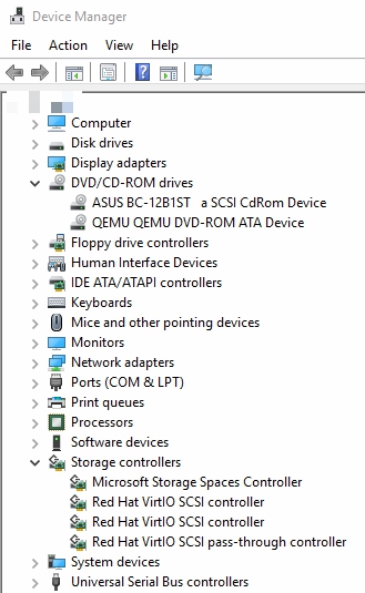

Just an FYI ... I followed the steps documented earlier in this thread (editing the XML file for the VM with the values returned by 'lsscsi' for the necessary drive) on 6.4.0 and it works fine on that release, in a Windows 10 Pro VM (10.0.16299, Build 16299). Unfortunately, I did not have a need to use my ASUS BC-12B1ST Blu-Ray drive until about half an hour before posting this, which was after I had upgraded to 6.4.0. So, I cannot answer for certain if this would have worked on a 6.3.x release.
However, VM performance was very choppy/laggy through VNC/TeamViewer until I managed to get the Red Hat VirtIO SCSI Controller driver installed ... and I'm talking really laggy/slow. Was almost painfully slow. Had to use keyboard to navigate through Windows because the mouse was just unusable for me, until after that driver was installed.
This was on a host with an EVGA SR-2 motherboard (BIOS A58). Drive is attached to one of the on-board SATA2 ports.
