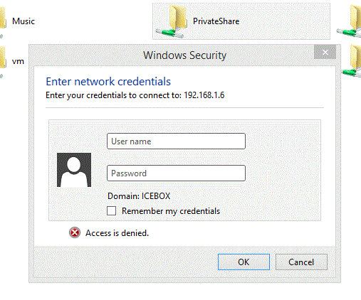

As with beta10, I'm not able to access Private disk shares with beta10a.

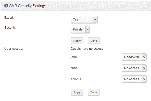

I created a new private share and granted myself R/W access, no cache. Navigating to it via Win8.1, Windows said that access was denied and prompted me for my credentials. I added them and was still denied.
Same with secured shares. I can access but when I try to create a directory, Windows tells me that I need permission to perform this action though I've been set to R/W.

Update:  The issue has to do with how Windows tries to specify the localhost of your workstation as the "domain" for the connection.  You need to type the name of your tower followed by a / and then your username.
E.g:
tower/jbartlett
Marking solved and dropping you a PM to make sure you see this ;-)
