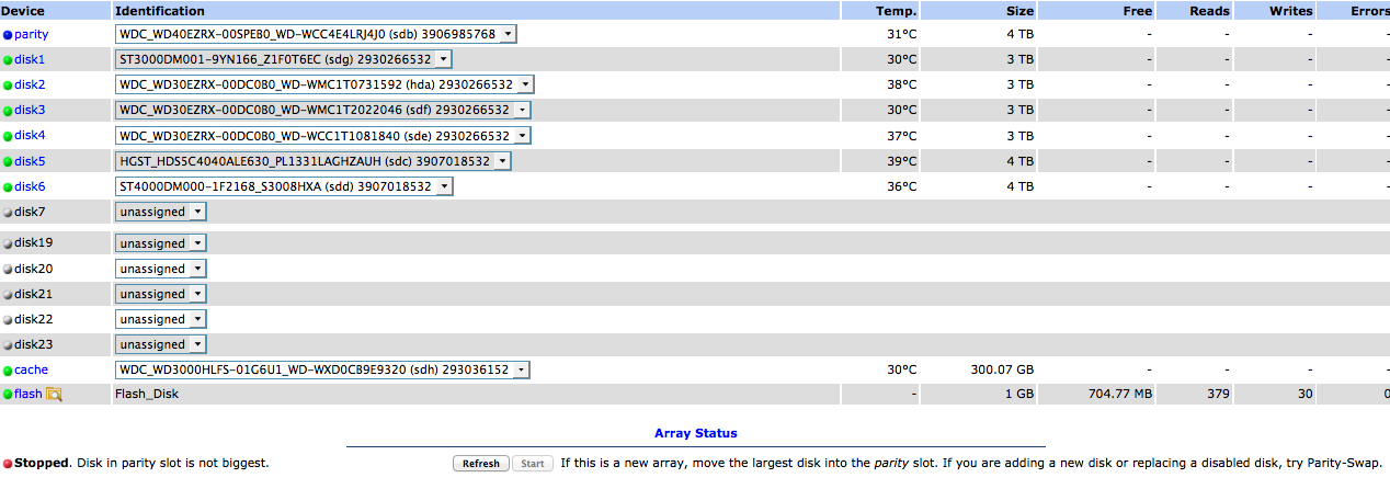

Trying to replace 4TB parity drive, but the new drive is slightly smaller :( :(
I'm replacing a 4TB HGST parity drive that failed with a 4TB WD Green drive :(  And unraid won't let me because it turns out it's slightly smaller.  Is there any way I can fix this without going out to get another drive?  Thanks!!

The gui shows 3,907,018,532 bytes for a 4TB Hitachi, while the SMART report shows 4,000,787,030,016.
Preclear also shows 4,000,787,030,016 for the WD red... which would mean it would fit... it's exactly the same size as the Hitachi it replaces...

Argh I'm so sorry! Should've mentioned I ran a preclear on it already.  And it said it was successfully precleared.  Maybe it wasn't done properly?
The preclear was run on a difference computer though.  Then plugged it in, and got this.  Is there a way to check if the drive is precleared?  If that's all that would take, i'd be soo happy!  I don't mind running another preclear.  Downloaded HDAT2, will run that as well when I get home from work.

I think I'm out of luck.  Seatools didn't work.  If I choose "set to max", it gives me a dialog box, same as the "set manually" and then nothing happens.  I think the WD green drive is smaller than the HGST drive.  I may have to look for a 5 or 6tb drive and just bite the cost.  But how -N failed is very odd.
I'm using the same make/model drive as my parity and I can confirm that it should be the exact same size as every other 4TB drive:
parity WDC_WD40EZRX-00SPEB0_WD-WCC4EF2YL0NZ (sdb) 3907018532 * 4 TB
