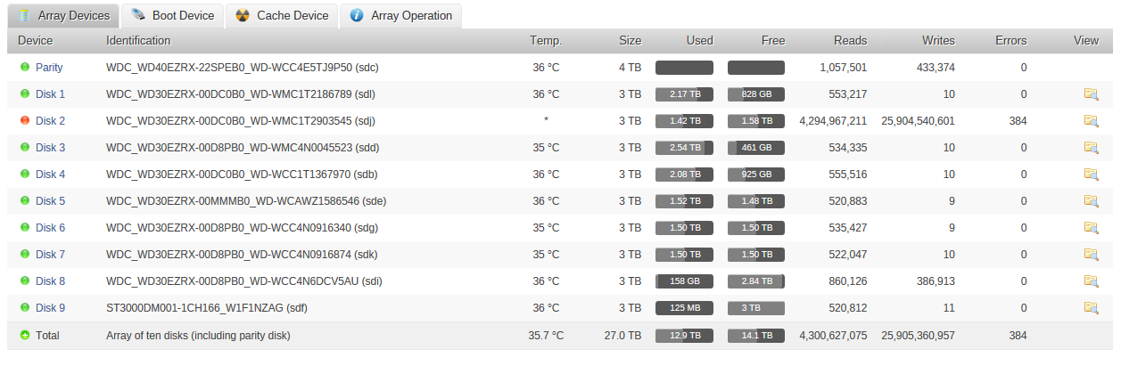

You say a parity check hasn't been completed, but has a parity build completed? Or is your parity showing invalid? Maybe a screenshot would help clarify.
Screenshot and syslog attached
Syslog show all sorts of write errors around 16:00 that when parity failed.
Screenshot shows 384 errors; that number hasn't changed since I stopped the parity check when all these errors started popping up.  I did eventuality let the parity thingy run.  And well that's about it.

You were in the process of rebuilding disk #2 from parity and all of the other drives combined.  Those errors are what keeps causing the rebuild process to stop (its a rebuild -> not a check...  the screen should say this)
After you grab all of the files off the virtual disk 2, you're going to have to solve why those ata errors are appearing.  Your supply should be able to handle all the drives, so it really comes down to tray issues / 8087 cable issues / controller.
