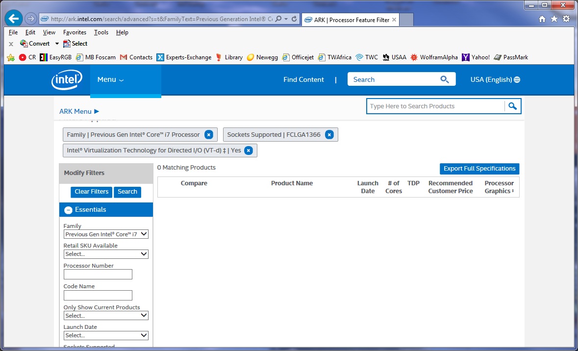

Not according to Intel.  It has hardware virtualization support (vt-x) but NOT directed I/O (pass-through) support (vt-d)    http://ark.intel.com/products/37147/Intel-Core-i7-920-Processor-8M-Cache-2_66-GHz-4_80-GTs-Intel-QPI
In fact, if you go to that generation of i7's, and search for Socket 1366 CPUs with vt-d support, there are NONE

No.  As I noted earlier, pass-through requires vt-d support.
Here's the result of searching for Socket 1366 and vt-d
